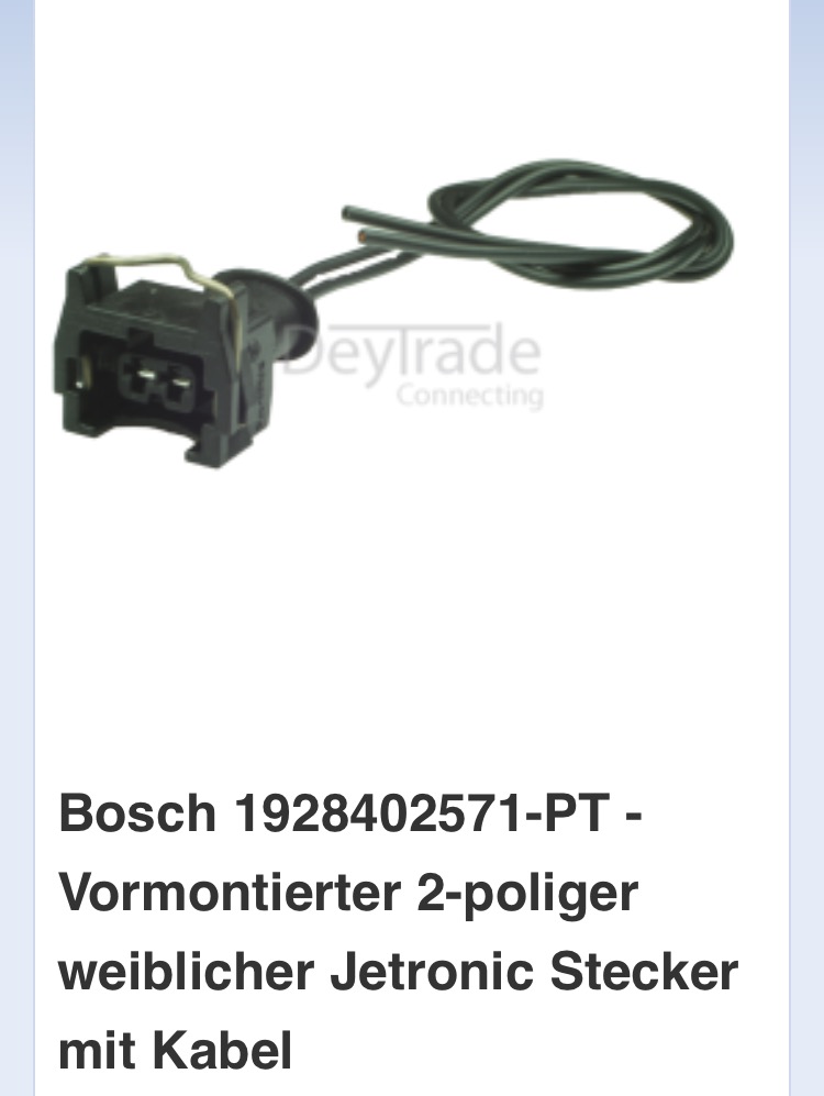

  6. I just replaced the connection to the N75 valve. Also not necessary to buy the entire wiring from Porsche. Its a Bosch Part for 3,50 EUR

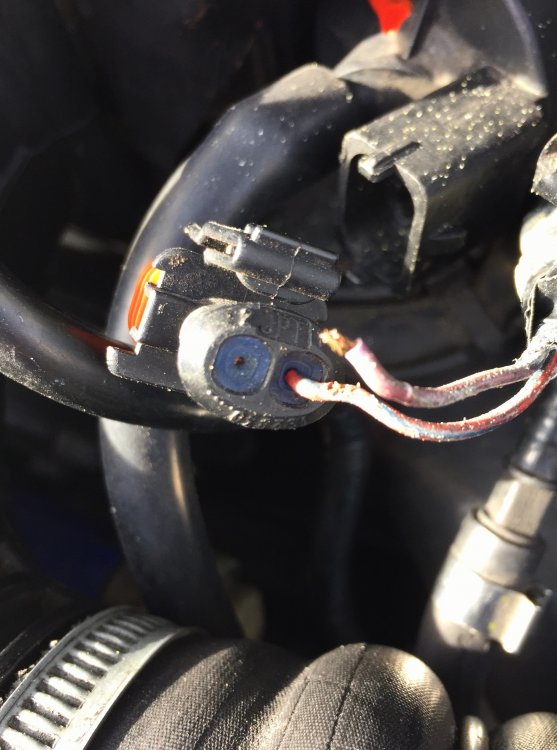

  7. If anybody ever going through the same problem. The purge valve wiring/connector failed because the wiring became briggle. There is a chance not to buy the entire wire. The connector is available from Bosch for 6.50. Was one reason of many for my bad running engine 0 Quote Edit
  8. If anybody ever going through the same problem. The purge valve wiring/connector failed because the wiring became briggle. There is a chance not to buy the entire wire. The connector is available from Bosch for 6.50.

  10. @ Lewis Thank you very much. Actually if i was a little bit more handy i could fix it but ... i will see what i can do. The wire is broken and the one end which is inside the connector is so short. Difficult to connect. I will check ebay for a similar part .
  11. I fixed the wiring with some special glue but i would prefer to replace this entire connection. Can find it in a parts diagram. Maybe somebody can help please.
  12. @ Lewis by the way did you check all the electric wiring in the engine bay? Age and of course temperature changing makes them briggle. When i saw my headlight wiring i can imagine others looks soon the same. Today i found the reason for my CEL. The wiring to the purge valve was damaged.
  13. @Brainz006 Now it makes sense. I had a hesitation and strange running and vibration for month. Changed so many parts except the purge valve (which even showed a code). Couldnt solve it. Desperate. Lewis always told me change the purge valve and finally i did. so i guess it maybe was not one of the hundreds of vacuum tubes which caused the leak. It was the purge valve :-(
