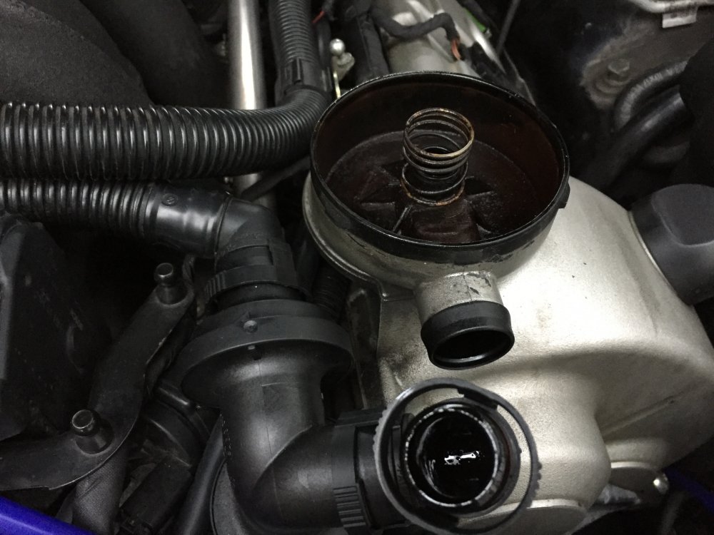

  2. Many times already it has been discussed in the forum about the importance to take care about these cam shaft tabs when working on the valve cover. would like to ask what this tabs are doing? Would a problem causing constant rough running? Misfires? In all rpm range? In some specific rpm range? if the flap would be broken, how to replace / repair?

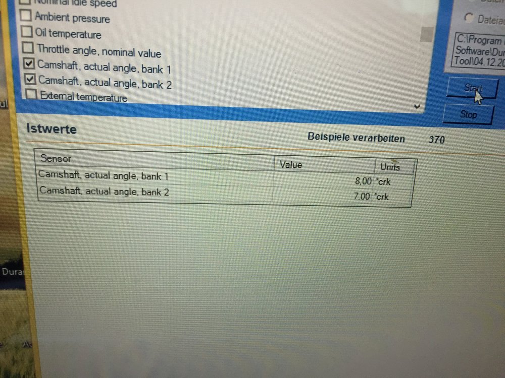

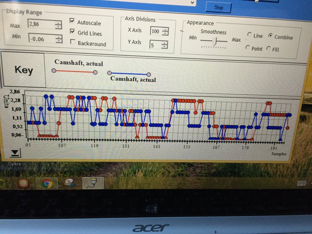

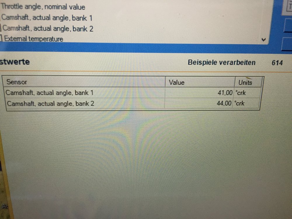

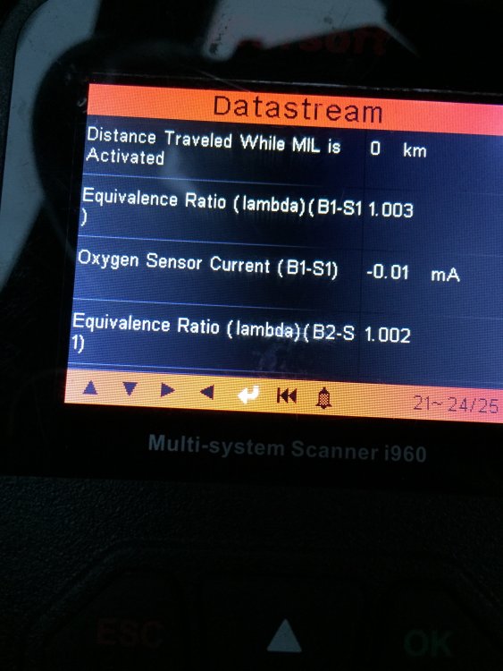

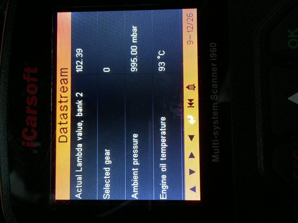

  10. So guys i need your help here. Still affraid i could have a timing issue. I read the values with my durametric cable but i cant interpret the numbers. Maybe somebody can assist. The lower numbers are at idle and the higher ones ar 2000 rpm.

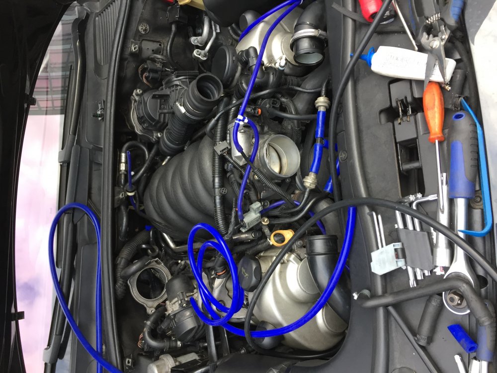

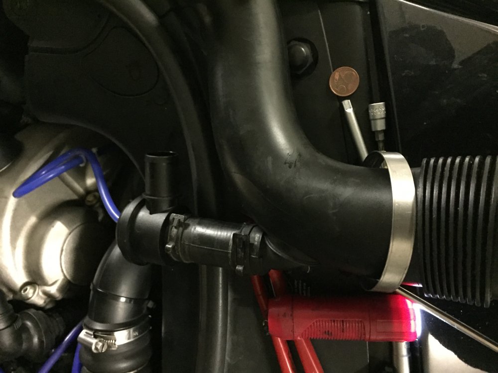

  12. Changed the DV Valve into the right position. Pressure line position down like it must be. What a pita. Thats the result if working to fast and not careful. ****. My mistake. Took me again hours because everything so tight there. Again oil in the turbo to intercooler hose. Maybe normal. Did just short testdrive. 0 degrees and difficult road. Power and throttle response better but there is still this whistle noise when accelerating harder. Still somewhere a leak.

  16. shame on me i made a very big mistake. Because of my ongoing problems Our Specialist Lewis ask me this days if i am shure that my Diverter Valve which i changed in summertime is mounted in the right way. I didnt even think about that it was possible to do something wrong. But i did. IDIOT stupid me. It was installed upside down. I only hope i didnt to much damage to my turbo charger. I could bite my .....
  17. You believe its abad solution to use silicon pipes?
  18. Hi glad if all this posts bring us to a solution in the end. Same time i am very glad for any input. Someone may ask why i just bring it to the service point and let it get fixed. My experience with this kind of problems usually ending up with days of labour and sometimes no solution. When i take my first Cayenne to the shop because of random PSM failures they changed almost everything and guess what: the problems still came back frequently. Thats why i want to try to fix this by myself with your help. Maybe day will come and i give up on it and give it away. I am not on this point yet. I used pipes with the same diameter like the original ones. Heat resistant up to 240 degrees celcius. pressure lines from N75 valve to wastegate: inside diameter 4 mm. Many small pipes arround the y pipe have same size. the bigger pipes which you see on the pictures from yesterday have 9 mm inside and they fit very good and tight. One pipe which is going from the change over valve at the back of the engine along the fuel rail on drivers side to the front is 6 mm inside diameter.

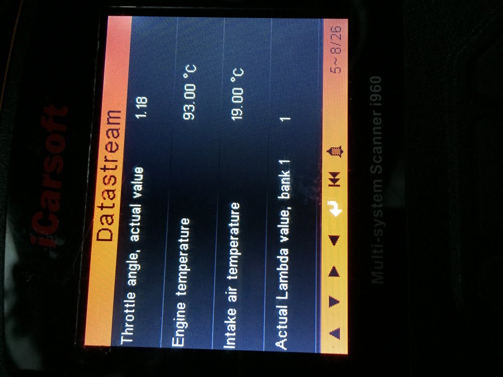

  19. Thank you Mark. The OBD device is a Icarsoft. I will see if i can find some explanation. My Durametric cable doesnt read the values at all. Dont know why. I will see how the reading is under WOT. Will try tomorrow
  20. maybe some professionals could please have a look to the OBD readings and try to analyze the values. Actual lamda value bank 1 and bank 2 so different numbers but i cant interpret.
