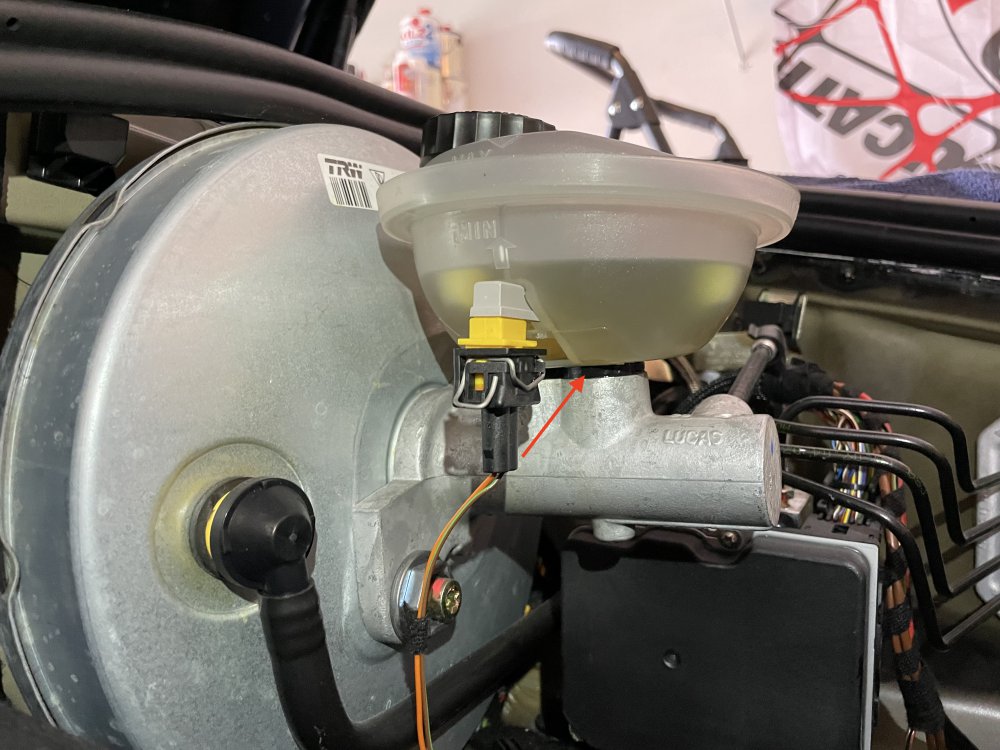

  1. I normally use 10-15 psi. Pumped in 10, walked away for a few minutes, came back and it was at 5. After taking off all the plastic covers, I can see the fluid slowly leak out when I slightly move the reservoir (without the power bleeder attached).
  2. Hey All, So I noticed a leak between the master cylinder and brake fluid reservoir on my 05 997 Carrera. I was doing a brake fluid flush which I've done a few times using a Motive power bleeder and noticed the pressure started falling even before I opened the brake caliper nipple. I finally found some brake fluid oozing out between the seals of the master cylinder and reservoir. Given the 911 is 15+ years old now, I expect this is normal. Questions: what do I need to replace here? The seals seem to be part of the master cylinder so I assume I need to replace it? Should I replace the brake fluid reservoir as well? Thanks in advance. -Oscar
