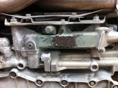

  8. Thank you guys. Pics would be great. Any idea why this part would develop a tiny straight line crack dead in the middle? Its not load bearing . Bad casting? 13 year old car ...parts just naturally wearing out?
  9. Found a small spotting of coolant dead center of engine at rear under cats and in front of pulleys . Thought it was water pump related, but turns out its the part that the coolant drain plug is cast into. Picture attached should help identify this. What is this pump housing part called? For now we JB welded it. Hopefully this patch will hold until the correct piece is located along with a new water pump probably since I'll be in there. As always, much appreciated for the help. Phil B
  10. Here's the update on this issue. Maybe it will be of use for others. Your suggestion to do a pressure test at temp was spot on. The tank was also a culprit as well as the failed cap (00). Figuring that the tanks was the original, we got the correct tank ( 147- not the 157 designation ) and also changed out the hoses. During the test we also found a single drop of coolant on the water pump housing inlet/outlet? It was perfectly straight. We think it's a failed seam on the metal? Thoughts please. For now we re sealed it with JB Weld, let is cure overnight and all seems well. Even though Robert supposedly vacumed the top off after refilling close to 2 gallons of coolant, The tank was about an inch or so down when I got home today? I've let the car cool, removed the cap and re topped it with distilled water. A thourough inspection underneath reveal a dry car all around ? Only thing I can figure is Porsche is like BMW with trapped air after working on RADS etc. My old 535 wheesl had to be elevated about 2 feet in the air to burp the system. As always, help is greatly appreciated.
