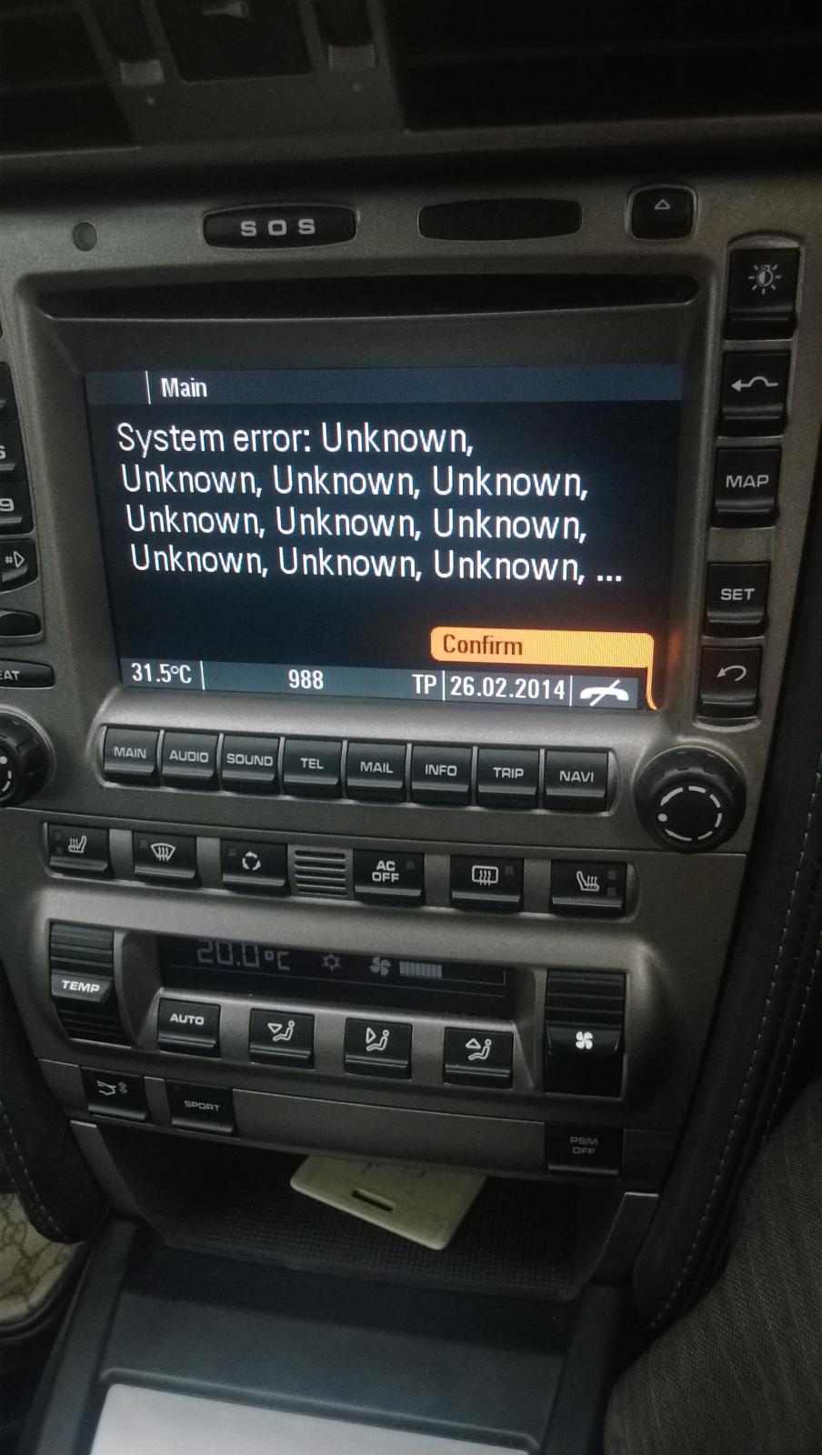

  12. Hi, I have problems with PCM 2.0 in my 04 CS. I get message 'System error: Unknown, Unknown, Unknown...' every time I start the car. When I press confirm, message goes away. The whole system (radio, navi, phone, cd, cd charger, trip computer...) is working without any problems. There is just that annoying message, which making me nervous every time I sit in the car... Does anyone know what could be problem? Here is picture which I borrowed in 997 forum. Thank you.
  13. I also have exactly the same problem. Please let us know if you find out where the problem is. Thank you
