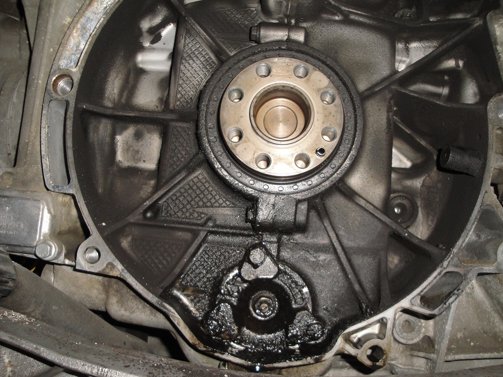

  22. I wasn't motivated to get up early today so I pulled the trans this afternoon. This is how bad it looked which kind of surprised me because I had no oil on shop floor where car stays parked. Anyway, any thoughts? Most of the other parts will be here next week. A really odd thing is the two clutch cylinder bolts were finger tight. The car had the trans mount replaced at dealers expense after my PPI revealed a bad trans mount. The bad part is the work was done by a top Indy with a great rep. Guess even the experts forget to tighten bolts sometimes. Anyway, looking at pic; Some RMS and some IMS or mostly IMS leaking?
