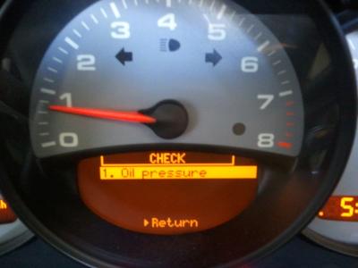

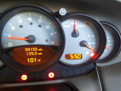

  13. My oil pressure guage rest just below the '1' but will move a little lower and rise almost to '2' with the key in/engine off....so I'm wondering if a bad pressure sensor is the culprit to the 'low oil pressure light' I get. To accomplish 'ground the singal wires at the sensor' can I just touch one of the leads to the body of the car, suspension, engine block? I've been chasing a 'low oil pressure light' occuring at idle, and strangely, only in the afternoons. No codes on the Durametric, even plugged in while light is illuminating and still nothing (meaning nothing on DME or instrument check). Throttle body, plenum, air distributors all cleaned when new hose that snakes from the AOS across the top of the block to the other side was replaced; replaced oil filler tube, clutch and RMS (no problems with IMS leaking) at this time too. Mechanic checked AOS (which was replaced 8 months ago) and believes it is all fine, secured etc. So I'm really hoping it is the sender.
  14. Thanks RFM...one more question...can you recommend the oil pressue tool? Does it attach to the oil filler tube? Tim.
  15. I'm receiving the low oil pressure warning light; I've been working with an indie mechanic who has completed work yet the condition persist. It only appears at idle, and then only for a brief moment. It doesn't always appear, for example, my wife drove the car yesterday and no light. But then, maybe the car just likes her better than me. The car also refuses to cooperate when it is at the indie; again, maybe the car prefers his company over mine too.....So, his solution has been to replace the crankcase breather tube. It was improperly installed by a different indie mechanic who replaced the AOS nearly a year ago; it had four large cracks in it. He felt that perhaps this was a leak in the system causing the light. unfortunately, the light appeared the next afternoon during my commute home from work, but with four large cuts in the hose, it still needed to be replaced anyway. While the car was at the garage, I had the clutch replaced; he also replaced the RMS. There are no issues with the IMS, and there is absolutely no oil leaking from anywhere on the engine. It isn't as clean as OrientExpress', but it is pretty clean! The oil pressue sending unit was replaced last summer. So neither I or the indie have paid much attention to it other than checking that the connectors or connected to it. So I puchased a Durametric hoping I could catch it right when it happened. The only fault codes are one regarding the radio and one about the lumbar sensor in the seat. I keep the oil level right at the top mark of the dipstick; I use the recommended Mobile 1 0W 40. I recently performed a seach and found a thread that discussed a similiar issue; I think Loren had posted a response that outlined searching for fault codes and then something about a line test or something like that if there were no faults. I can see the Duramtric has a tab about line test; problem is I cant find that thread again. So my question is if that thread is familiar to someone and could point me to it or explain what 'line test' I should be performing.....or if someone has had a similiar experience and solution. Tim Las Vegas Here's an update: I was able to get the car to communicate the oil pressure error message. This instance the red dash oil 'idiot light' (along the row including the 'park' and 'seat belt' light below the tach) didn't illuminate or it did so briefly that I didn't notice it. When I got home I left the car running, hooked up the Durametric and found no codes, other than what I listed in my original post. I turned the car off, removed the key, reinserted the key and restarted...the dash/instrument cluster error message seen in the picture was gone.

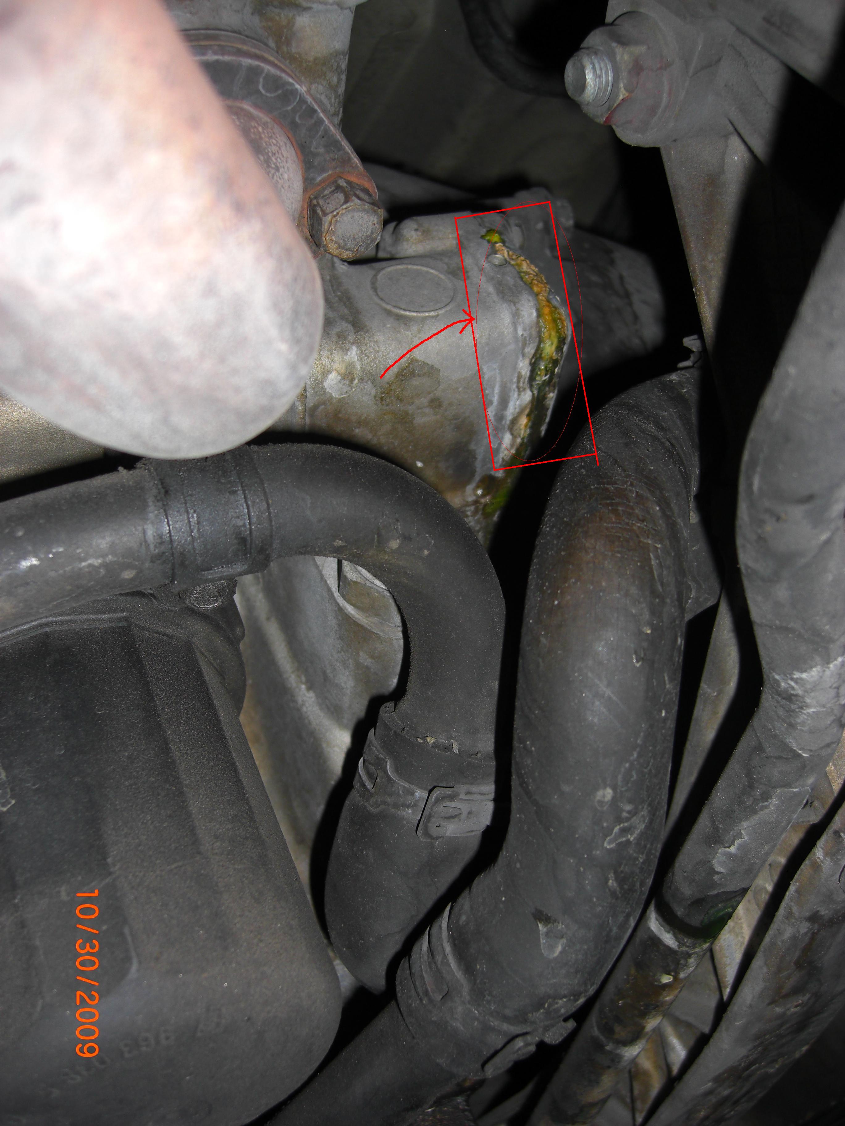

  22. Can anyone tell me what this part is? I've got a small leak of cooling fluid from it. I've 'drawn' a red square around the part. It looks like it is held in place by two bolts; I'm hoping that I can remove what appears to be a small square cover plate, replace the seal, or gasket, without much trouble. It is on the passenger side, front of the engine; in the picture you can see the oil filter cannister as a reference. Thanks! Tim Las Vegas
