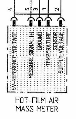

  4. Thanks Loren. I've verified that it's plugged in. I also looked for fused but I didn't find any blown fuses (in fact there is no fuse for the MAF!!) Between which two pins of the socket (or the MAF itself) should I look for open ckt or short? I can borrow a multimeter ... After much hunting I found the diagram for the MAF. It's so do you know between which two terminals the open circuit/ short circuit might exist? I presume I have to verify this (short/open) on both the wiring plug as well as the MAF sensor socket?
  5. Thanks Loren. I've verified that it's plugged in. I also looked for fused but I didn't find any blown fuses (in fact there is no fuse for the MAF!!) Between which two pins of the socket (or the MAF itself) should I look for open ckt or short? I can borrow a multimeter ... Thanks, this sounds a little involved ... if you have tips, I'm all ears ... otherwise on pelican's website looking at the diagram :) !! And I'll check the fuel cap too!
