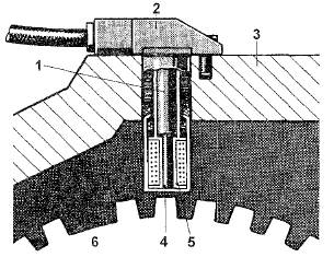

To precisely determine the crankshaft position, a reference mark signal is required.
Engine speed and reference mark are monitored via an inductive sensor. A larger gear notch in the ring gear (on the flywheel) serves as reference mark. The larger notch induces a higher voltage in the sensor.
A soft iron core partially bundles the magnetic field produced by the permanent magnet which then enters the space and closes again through the magnetically conductive parts of the engine. A steel toothed ring moving past the face of the sensor affects the magnetic field. The change in the magnetic field induces an electric charge that is used by the DME.
A fault code is stored in memory when no crankshaft position sensor signal is recognized within 60 crankshaft revolutions and the engine speed is above 500 rpm.
1 - Permanent magnet
2 - Sensor housing
3 - Engine case
4 - Soft iron core
5 - Inductor coil
6 - Reference mark

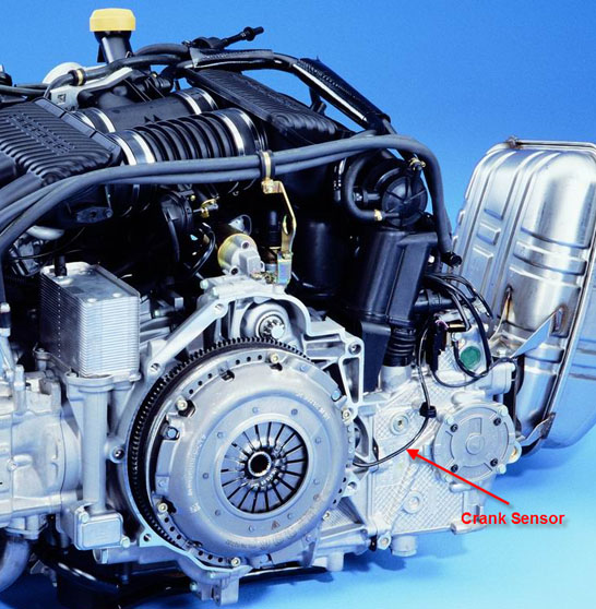

Thanks alot for your very technical and through explanation Loren....I sincerely appreciate it. This is an ignorant questions, but could you tell me where on the engine case that bad boy is inserted? Also, what happens when the DME does not get a Crankshaft Position sensor signal? Is it damaging to continue to drive? Are there any negative consequences to not having an operational CPS? If I had not run codes, I would not have even known that there was a problem. Thanks in advance!
Here are two pics - the first one shows a complete engine and where the sensor is in relation to the flywheel.
The second one (courtesy of Jim Pasha) shows how it protrudes into the flywheel housing. The sensor can be changed without removing the engine or transmission.
