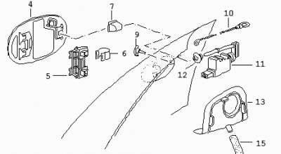

It sounds like you had the same problem that I had.
Take a look at the parts diagram above. If you're missing part no 6 (the spring clip), then just buy that and clip it back into place. In my case, the spring clip was neither missing nor defective.
I had to replace the plastic hinge, part no. 5, which is not very easy. Mainly, the problem is getting the old one off. Since it's plastic, the trick is to yank it off or pry it off without scratching the car. Study the instructions in the link above on how to remove the gas door.
I did this two years ago, so I don't remember all the details, but make sure you tape the gas door and the surrounding areas of the body with duct tape to avoid scratches. Also, once the gas door is off the hinge, it's going to either fly off or fall on the floor or the body of your car, so having someone hold onto it will help avoid damage.
Good luck.

I have the spring clip. How do you tell if something is wrong with the hinge?
Is the spring clip tightly in place? It shouldn't move around at all. If it does, you should be able to re-install it properly using the instructions above. Also, see if there are any small black plastic pieces that broke off the hinge. In my case, I saw a broken piece of plastic and realized that was the problem. Most likely, your problem is the hinge if the gas door is flopping around when open.
