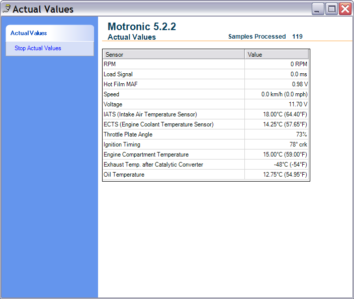

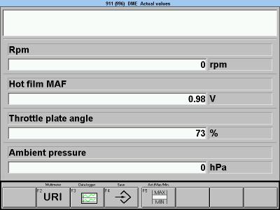

You need the PST2 to check for fault codes and to verify that the throttle is reading 80% at full throttle.
The Durametric software can give you those same readings.
When I pull it up with my OBDII reader and watch the real time stats, the throttle position stays flat at 5.19% at idle and when the pedal is all the way down. The MAF rate is flat in all positions too, never changes. Once I clear the codes, everything runs normally, but at full throttle the throttle position is 100%. Is that something that can be cured by plugging in a PST2 instead of the OBDII?

The Durametric Software can read and reset codes for ABS, PSM, AC/Heating, Airbags, Tiptronic, Seat memory, etc. It can read but not reset alarm codes.
I don't know of any other tool that can do that besides a used PST2 ($2000-$4000 on eBay) or a PIWIS $18,000 at your dealer.
