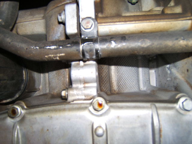

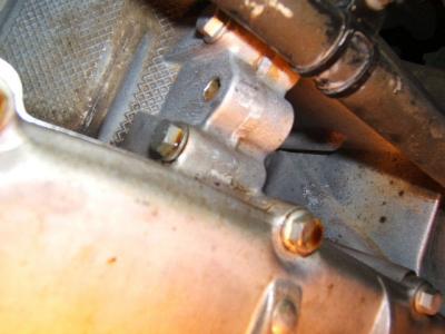

Loren, below are two pictures of the bolt where the leak is occuring. In the first picture, the culprit is the bolt that is just to the left of the center oil pan bolt. To give you a point of reference, this bolt is towards the front of th car just forward of the oil pan. Although there is oil visible on many of the bolts in this picture, the only one leaking is the one I have pointed out (the oil leaks from there and migrates elswhere). The second picture is a close up of the leaking bolt. Thanks for the help!!!!
Yes Loren. The seepage comes right out from under the head of the bolt. I tightened it last night just a tad and cleaned the area. Will check tonight to see if the leak persists. If that doesn't work, would you recommnend draining oil then reinstalling the bolt with some RTV? This seems like strange place to have a leak, unless I'm somehow missing the actual source, but the entire area around the bolt was dry last time I checked.
