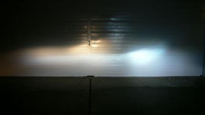

The stock halogen lights have the european code light cut off like this. ____/ if you have ever driven close to a wall you will notice it. I took before and after pics. The cut off was exactly the same with no glare or light wandering away. The cut off on the stock lights is really good and cuts the hid off just like the stock bulb so you only get light were the factory light intends it to be unlike most cars. Generally hid retrofits in stock housings have light all over the place which was the case for me a few times. This is NOT the case with Porsche lights, lucky us.

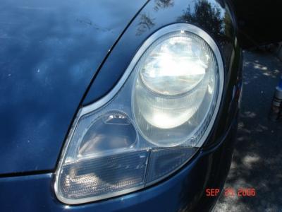

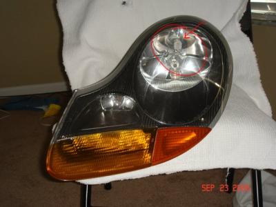

Here are some pics. Notes for each pics are under.
Halogen lights as stock from Porsche.
HID retro fit installed. You can see the cut off is exactly the same on the wall. The car is in a slightly different spot here and it's much darker ouside in this pic making the lights look a lot brigher. More or less the light is exactly the same and in the exact same position.
Halogen light stock.
HID Retrofit with fog on to see difference.
Stock H7 vs. HID H7. You can see the arc point is in the exact same spot. Might be hard as I'm holding the bulbs but they were identical.

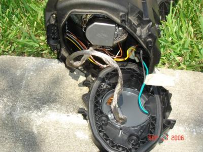

Headlights outta the car. 30 seconds a side really.
Stock bulb out. Got kinda hot there wow. HID are cooler running so thats good. The top is the low beem. The HID retrofit goes in like stock. Just run the wires out the plastic cover, drill a hole.
On the front of my house. Same as stock cut off.

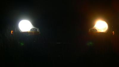

Color of HID 5000k retrofits.
Color of stock halogens.
Just incase you wondered about HID retrofits, you can now see they are just as good as stock. You get the light of HID without 1300 bux. Remember real litronic are better, self leveling etc. so they are worth the money. For $200 you get more light output than stock, the nice HID color, and no downside typical with HID retrofits.
I think that Porsche did a really good job on the stock headlights as they have good cut off from the factory. With a lot more light output from HID lights, they still control the light very well and get it right on the road with no glare.

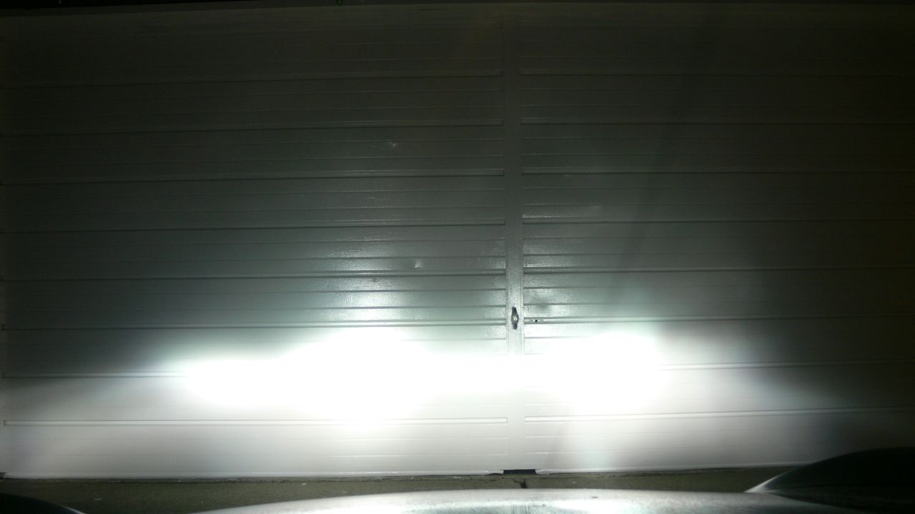

I just installed the same HID system you had put in. I noticed that the aim on the HID seems a bit lower than on the Halogen. Did you notice the same on yours?
This just shows the colour difference
Notice the height difference. The Halogen is aimed considerably higher and also the angled slant cutoff seems more prominent on the Halogen
This is with both HIDs installed - the left and right both aimed at the lower point now.
Mine were the same. I'm not sure that it being lower is really a problem however as they HID is brighter and the extra light being pointed a little lower shouldn't be a problem. If anything it will save you from problems you might have otherwise had.

I'll take some time tonight and make some measurements on the headlight alignment. The manual says 1% grade.
Also, after reviewing and comparing your photos and mine, I see that your cutoffs are much more pronounced than mine. I wonder if the bulbs are a different batch (from CQ) or if the Porsche headlight enclosures are slightly different. <_<

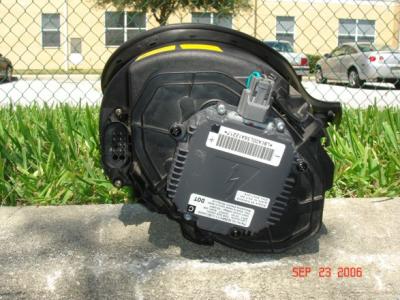

I am just about to start installing 42w HID conversion kits on my 996. It would be really helpful with some tips on the placement of the ballasts and the igniters. Did you manage to find room for them inside the wing, or did you have to place them in the luggage compartment?
I did this conversion on my 1999 996 C4 last month. I found that the best place to locate the ballast unit was on the 'shelf' between the wing and the headlamp unit guide frame. I cleaned the surface with a solvent cleaner, and then stuck the ballast units in place with double sided adhesive tapes (the system I used had a single ballast unit with integral igniter). I could have drilled and bolted them, but didn't see the need. I was concerned that the ballast units might get wet (they use high voltage on start-up), but this has so far been OK despite some really bad weather and flooding in the UK. I was originally planning to mount the ballast units in the luggage area - but the conecting cables between the ballast and the lamp unit weren't long enough (you need to be able to withdraw the headlight with the cable still attached) and I did not want to extend the HV cable. I removed the plastic inner wings to do this mod, but it is possible to complete the work without doing this.

I managed to install the two 42w ballasts on the "shelf" next to the wing, fixing them together and placing them sideways. I attaced them to the shelf using double sided tape as well as some silicone, in case the tape loosens with time.

I placed my ballasts in teh same location, however I just zip tied them to some existing wires that were running past the area so they didn't flop around. There really isn't anywhere for them to go so not much to worry about really, and seems like there is ample room for them back there so nothing gets tangled up.
