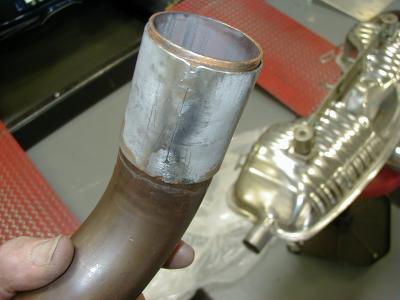

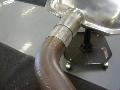

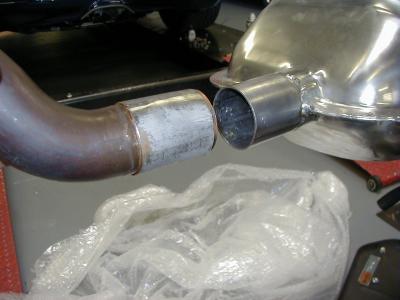

I Recently had the new Dansk sport muffler with the twin tips installed on my 02 2.7 liter Boxster.
The problem was that the openings to the Dansk muffler were about 1.5 mm too large for the pipes coming off the catalytic converters. This required the installation of bushings and added several extra hours (and $$$) to the cost of the installation.
I was wondering if anyone else has encountered this problem?

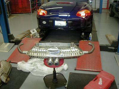

Normally, the ends of the tubes are split. In pic #3, yours look short. Maybe your installer cut the ends off thinking it would make the install go easier? In any case, they should have just cut some new slots in the pipe so it would be just like it was before or like the OEM muffler. Because the ends, now, are not split, there is nothing crimping the muffler onto the pipes, so something will probably work loose or leak. Where'd you have the work done? I think you got a doofus. No problem with installing my Dansk. It could have been a factory defect, but easy to remedy rather than the convoluted half-solution your installer came up with. This will give you an idea of what the split end looks like: http://www.stuttgart.co.uk/cargraphic/986e...es/986exh_m.jpg

It shouldn't need any type of adapter. I would guess that your cat's have been replace with something else from another model or something changed. When a part made to fit all models suddenly doesn't fit one car, then something on that one car is different. Chances are that it's not an OEM mistake but more that something down the road in the cars life has been altered and now that part will not fit as they designed it to fit exactly on an OEM setup. So either a new pipe was welded on the back of your cat and or part of the muffler setup, the whole cat/muffler pipe has been changed, or (highly unlikely) your car is an OEM mistake.
Either way, a sleeve like what you did is perfectly acceptable way of making it work.

I've seen this same issue with a Dansk at least once before on one of the Boxster boards. I remember this same discussion about the tubes looking short and not having any slits. Could be an occasional factory defect that shows up. In any event, like mee said, easy enough to work around. Does tend to tick you off when you pay good bucks for something though....
