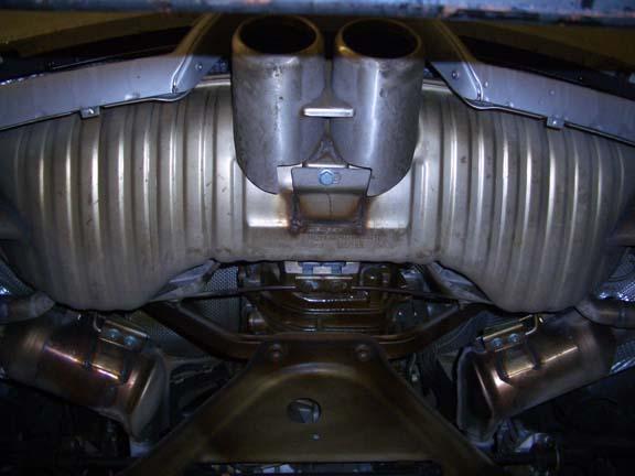

The kit i am looking for is the one shown in the following picture. Toolpants, do you know if that is the one with the part number that i mention?
I am not interested in the pre-2002 PSE with the wierd tail-pipes.
Nikos.
The part number for 2003-2004 kit is listed in the TSB section of this board and as a contributing member you can look at the TSB yourself. It is the same part number for the kit you and I have.
