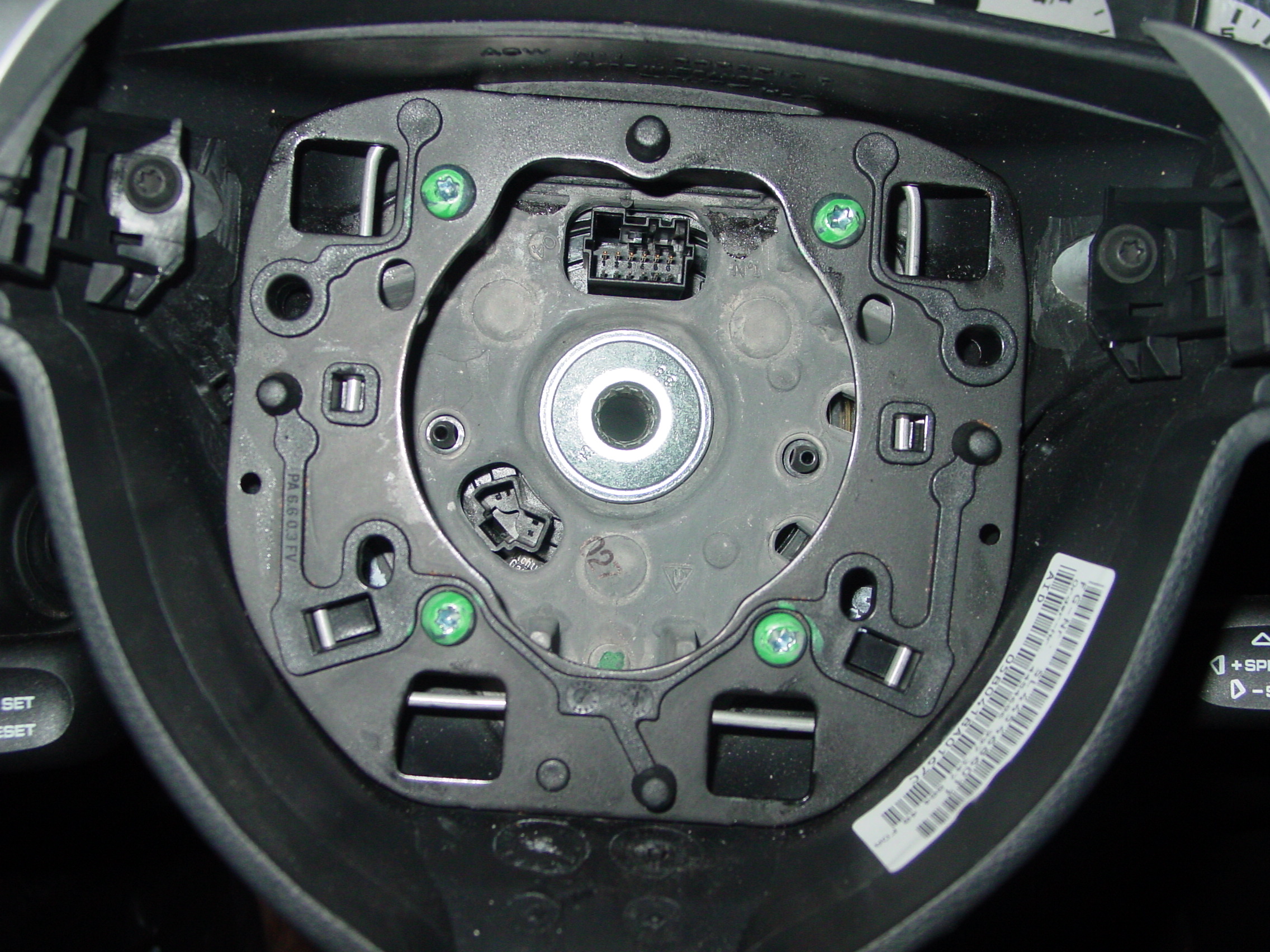

when i popped the airbag off the next 2 pictures show what I am looking at, it looks like some kind of torx hole? does anyone have any idea what the next step is?
I dont want to take this out then have a hard time re-aligning the wheel. Thanks guys.

I believe you use a 10mm or 12mm twelve point star bit. The bolt is put in with blue loctite so it takes some effort to loosen it. Once you have taken the bolt out the wheel comes right off. :drive:
Aaron
yeah, it is a 12 point T55 bit, and you retorque at 37ft lb. I was able to use a 6 point torx bit.
pretty easy once you have the tools...

Simple to get the silver covers off with the airbag removed. Getting the airbag off can be a bit tricky as there are 4 catches two at the bottom and one either side at the top. The catches are released when you put the screwdriver in the access hole in the bottom of the wheel , it moves a metal spring , releasing the air bag catches from the metal plate you see in the pic. I think the trick is to try and remove the airbag from the top ones first. Main thing is be patient !

Now, I can unplug the airbag wire connector plug, but the black wire harness disappears off to the right behind the plate that is held on by the 4 green torx screws. How do you disconnect that wire so the airbag and wire can be completely removed from the steering wheel?

The black harness has a connector on it, just disconnect it and remove the airbag.

Here is a brief description.
1. Put the key in the ignition but do not rotate it to the on position
2. disconnect the battery remove the -ve terminal only and make sure the strap cannot accidentally touch the -ve post
3. Turn the steering wheel to the right by about 90 degrees
4 On the back of the wheel at the 6 o clock position is a small hole (now facing the drivers door)
5 Put a long flat bladed screwdriver into the hole so that the blade sits horizontal
6 You will feel a spring tension as the screwdriver hits the lock spring
7 Push the lock spring hard with the screwdriver, the airbag should unclip .
8 Gently pull the airbag from the wheel starting at the top between the silver trim pieces.
9 With the airbafg removed remove the central tags from the yellow and green connectors on the airbag using a small flat bladed screwdriver, this allows the main part of the connector to be pulled from the rear of the airbag
10 Unclip the smaller black tag from the rear of the airbag
12 Use a Star spline 10mm size ? to undo the center screw. Best if you have a tube to place over the end of your socket wrench to give some extra leverage.
13 Unclip the plug from the column electrics in the rear face of the wheel (orange)
14 Make a note of the wheel position on the spline by marking with a felt tip marker
15 Pull the wheel gently off the spline
16 The wheel can then be dis assembled
17 Refitting is the reverse , but you need to follow the instructions in the owners manual following battery replacement to reset the PSM and the electric windows and clock.
All told you should take no longer than about 30 mins to remove the wheel. Faster to refit once you have an idea, and you do not need to tension the release spring to put the airbag back in.
