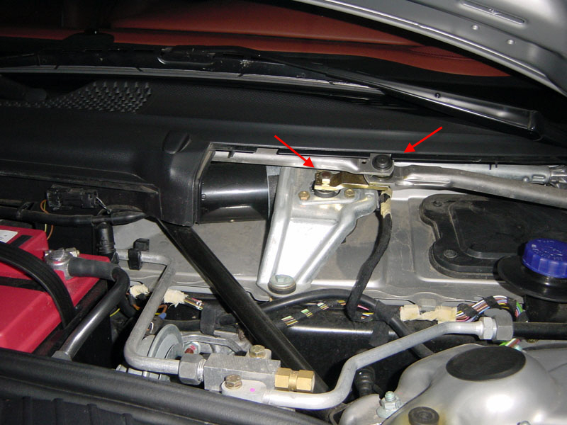

Wipers do not park
It could be the relay, or something else. http://www.renntech.org/forums/index.php?showtopic=10647 When my relay went out the wipers would not shut off, unless I pulled the fuse.
The purpose of the relay is for the park and intermittent features. Rule out the relay as the cause.
First, make sure your relay is seated. Then, find another 2.5/2.7 Boxster owner and swap relays.
