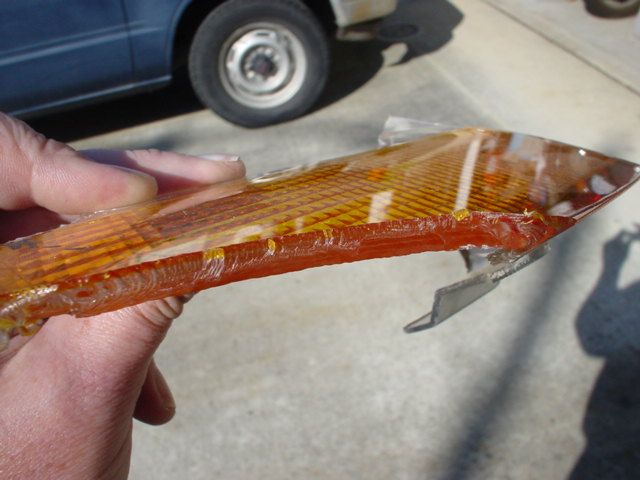

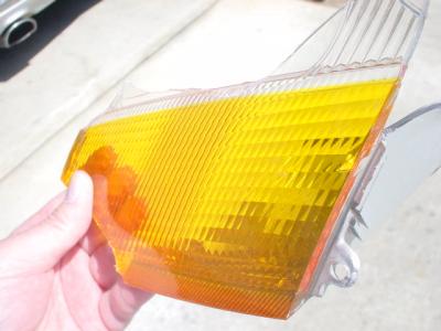

Not that I know of. The amber is not a coating. The plastic is solid amber.
Wonder if I could make a piece to replace that? I have access to automotive style plastic and I think I may be able to pull something off on my mill that would resemble that with out too much difficulty. Hmmm... that gives me an idea...

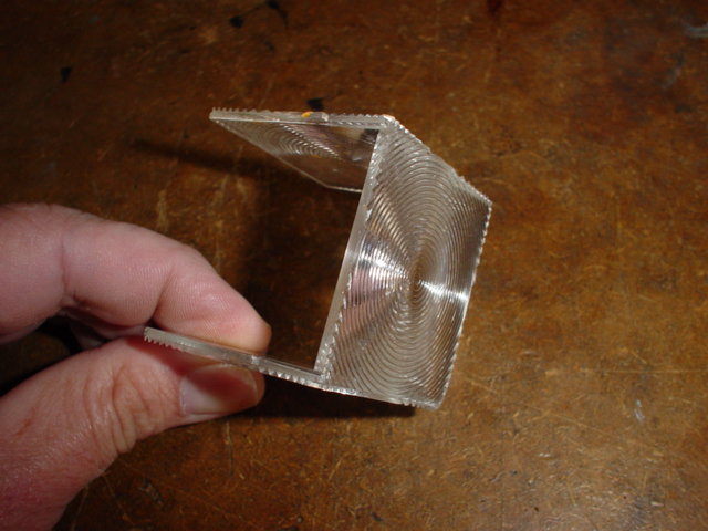

a side benefit of this is that the clear headlights from porsche have an amber insert that some people have used a soldering iron to remove. these pieces are already clear from the old amber style. so now i have clear lights with clear turn signals. also installed a chromed amber bulb, so they still blink amber. i am very happy to be amber free. also installed my 550 edition tails on the same day.

If you still have the covers for the amber headlights you might take some pictures so people can see that the amber portion of the headlight is solid amber plastic and not an amber coating.
