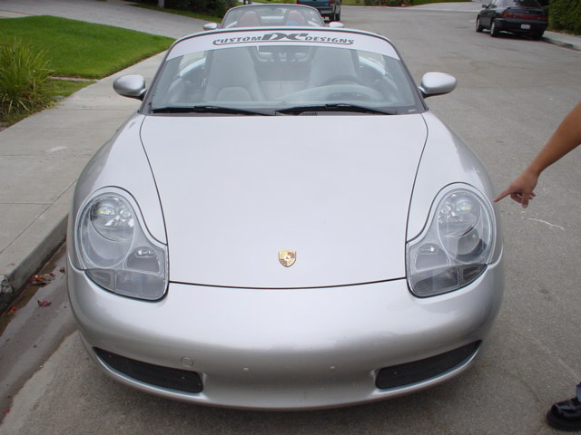

I would also like to replace just the Headlight lens, the PO installed lamps that melted/yellowed the lenses in there. Buying replacements assemblies is the recommended path.

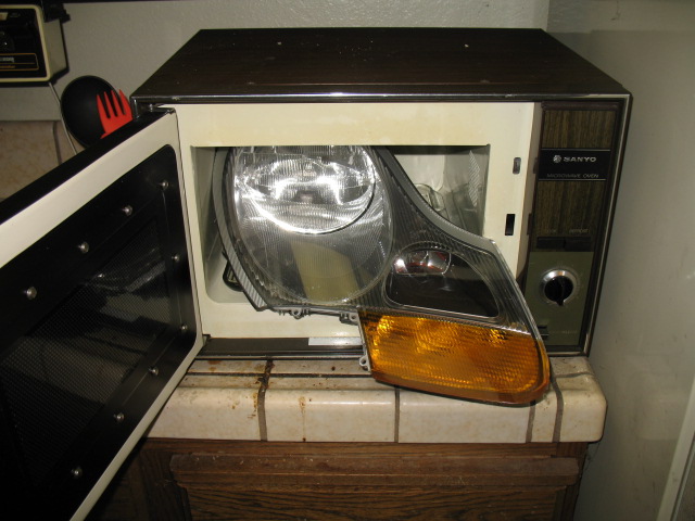

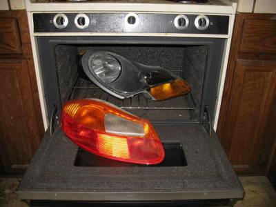

I did some surgury to my Jetta light, to get them appart I put them in the oven at 250deg for 10 minutes. Just wear some mechanics gloves when you pull them out they will be sorta warm, and the glue is warmed up enough that you can pull them appart. Do whateve it is your gonna do then toss em back in the oven for 10 mins and re-assemble. You want to heat it up before you put it back together so the glue will stick again. If you don't heat them up enough during the re-assembly you will get air gaps and get condensation in the glass, so the re-assembly is the most important. My Jetta lights are Bosch as well, so almost guaranteed they are madet the same way.
The grey around was the glue I was refering too. These lights are my aftermarket cheap-o ebay lights and they came appart fine and went back together fine and they were fine in the oven as well. The better bosch stuff is also fine in the oven. It's only 250 deg for 10 mins, don't do anything to the plastic, not to worry.

Someone with a trashed headlight might want to try the heat method and see if it works on a Boxster headlight.

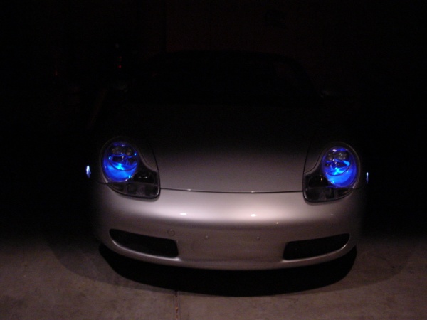

I have a trashed light. I will give it a go when I get a chance. I have been wanting some different looking lights for a while, without going down the standard Litronic route. That pic looks very interesting, TP. I like what he has done. Do you know what sort of projector setup he put in there? If I am going to go thru the whole oven thing, I might as well experiment with putting something new together.

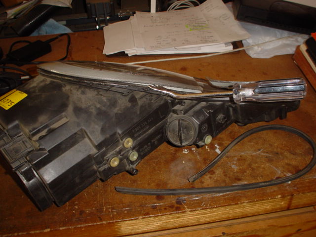

When I took my headlights apart. I baked them in the oven for about 10-15 min. at 250 degrees. Watch them carefully. You have to unscrew and remove the rubber seal that lines the headlight. Then use a screwdriver and slow start to pry the headlight apart.

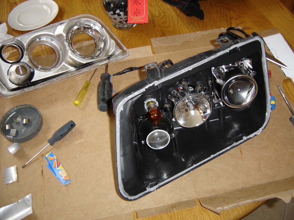

Danny, my plan was to buy a set of cheap chrome HID headlight assemblies like those Civic or BMW units on Ebay and cut and "paste" the projector parts of of the assembly into a empty Boxster headlight unit. I imagine the parts would need to be small to fit. Your fitment seems very good. Care to shed some light on which parts you used? Thanks.

Danny i just bought a pair of clears and the lenses were scorched be those "xenon" bulbs and i'd like to swap out my amber lenses into the clears. But boy i'm drooling at the piccy Toolpants put up on your projector mod. :clapping: Looks sweet. How did you do it and where did you get the parts.

I first took the headlight apart as discused in earlier threads. Then all you need to do is pop off the burnt lens on top. Since I wanted to run the driving/fog light combo I had to rip out the dome part as well. I believe they are just screws and clips.
I think mounted the light units to the sides of the dome using their supplied screws. I wanted to be able to adjust the angle of the lights, so I drill a hole in the bottom under the dome area, and placed a bolt in there, to tilt the lights up and down.
After that you just run your wires to the already stock harness inside the light. Seal everything back up and throw them back in!

I take the low and slow approach. I set the oven at 225-250 F, place the lamp assembly on a towel on a cookie sheet. After ten about ten minuets, start checking the pliability of the adhesive. There really is not a lot of open time to work with so you have to work efficiently when the glue is soft. A well fitting pair of heavy leather/suede gloves helps too, oven mitts don't offer a whole lot of dexterity :P
