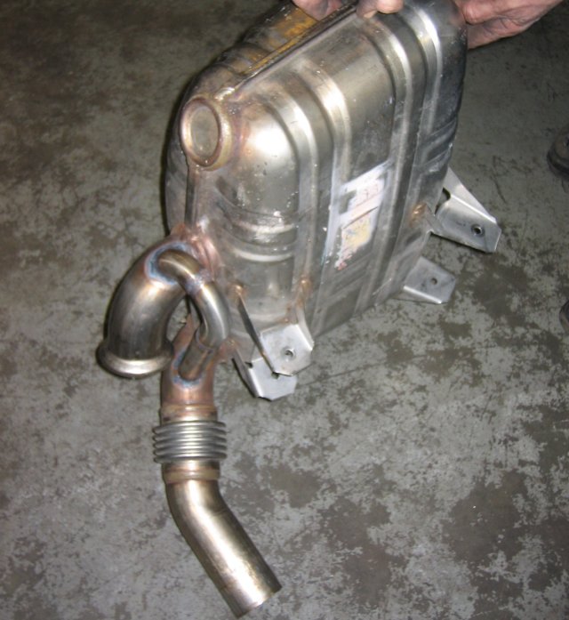

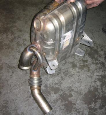

Richard, thank you very much for your response. I did actually search Rennlist (and Pelican, and 6Speed, and Renntech!) but all I found there are the 3.6 cans I mentioned in my original post.
By looking at the pics, I noticed that the Mk2 (3.6 motors I am guessing) have the bypass from the "top circle" to the "muffler tip downpipe", yet on the Mk1 (3.4 motor) the bypass is located between the "cat converter hookup pipe" to the "muffler tip downpipe". This exact difference is the one I want to make sure I get right. I have a 98 RoW 3.4 C2 and want to make sure that I cut the muffler right as I have no replacement in case I mess it up and importing one would cost an arm and a leg.
Are these to versions of the same mod on the same can (3.4)? If so, what difference did you obtain? Assuming stock mufflers is a level 0 and muffler bypass is level 100 (sound wise), I would like something like a 60. Any ideas or suggestions? Spending more than $300 is not an option as I am tired of spending money on my car and all I need is a louder exhaust (hence me not shopping around for Cargraphic, Fabspeed, Tubi, etc.)

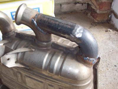

GOB, I felt the same way as you - I didn't want to spend a lot of money on a pair of genuine PSE's or the aftermarket equivalents. I bought a set of nearly new mufflers on eBay, and modified them as shown in the top photo by welding in 1 inch diameter stainless steel tube. This was the way that Porsche did it on their "first generation" PSE, but they put a valve in the tube to switch the bypass on and off. Because I was able to buy the new mufflers very cheaply I figured that if I didn't like the effect I could always switch them back. I was told that the "Mark 1" PSE was only suitable for 3.4 litre engines, but I don't know why.
I originally saw the modification from a couple of guys on the PCGB forum who had bought modified systems from a company in Germany called Oettle ( http://www.oettle-autodienst.de ). They have a soundfile on the site which you might want to listen to: http://www.oettle-autodienst.de/996soundfile.wmv - Oettle also sell the systems on eBay, but they say that they are suitable for 3.4 and 3.6.
My concern was that they might be "boomy" at motorway cruising speed, and also attract attention from my neighbours, as I live in a quiet dead-end road. I needn't have worried. Up to about 2000 rpm they are only marginally louder than standard, and at cruising speed they are as quiet as standard (inside the car). The real bonus is that there is a delicious roar when accelerating between about 2500 and 5000 rpm. On your scale, I guess maybe a 50 or 60 between these engine speeds.
The later Porsche PSE had the bypass as shown in the lower photo, but again it had a butterfly valve to shut it on and off. This picture was posted by one of the guys on the PCGB forum, and I havn't heard it myself, but he says it has the same effect. Again I was told that the "Mark 2" PSE is suitable for both 3.4 and 3.6 engines.
The cost of mine was a total of £150 ($280) including the mufflers, but I was lucky. I also needed a new set of clamps, as the old ones were rusted solid and I had to cut them off. It was definitely worth the effort though.

Hi - The 'Mk II' exhaust that Richard refers to is actually mine (Hi Richard..) - I've now put them on my 3.4 and they sound teriffic - as Richard says, a slightly deeper sound when driving normally but a much throatier roar when when hard on the gas and a 'sweet' sound at high revs when the cams are changing over ...
