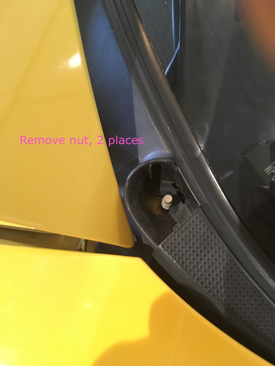

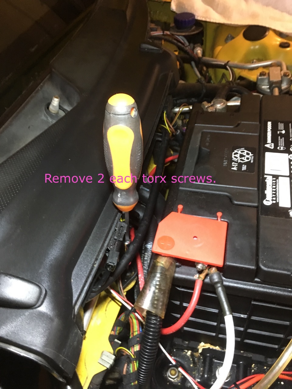

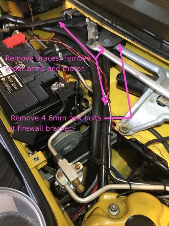

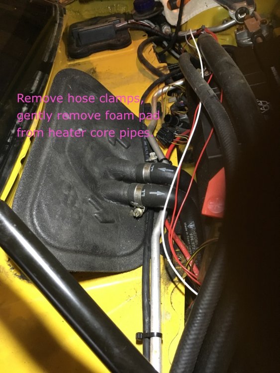

I started an update but stopped when I ran into the plug situation.  Here are my pix and comments so far.  I could take pixs of the open hole showing what I can of the flap door.
