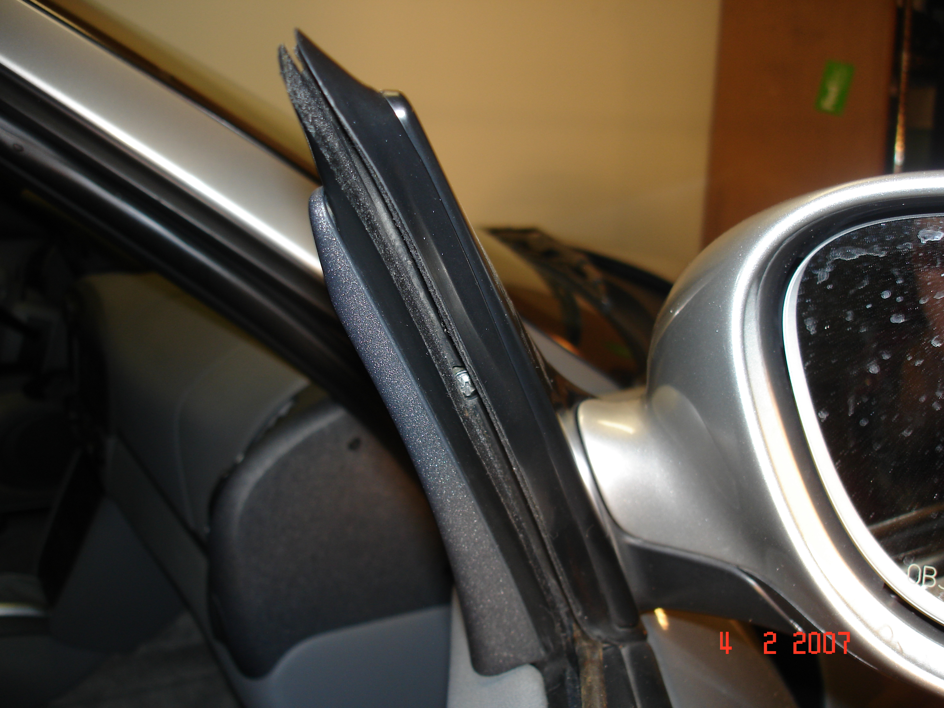

Has anyone experience with removing the side mirrors? I will attempt to attach pics to be more clear. There is a screw shown in the pic in line with the window that looks like would release the interior trim. I have the manual but there is no detail on how to remove that trim piece except to unclip, and same with mirror.
My question for anyone is how do you unclip the interior side mirror trim piece.post-4092-1170691494_thumb.jpg
update: just tried to take the side mirrors off, took me about 3 minutes to do. no need to remove door panels. just pry off the plastic caps as seen in pics aboe and you have access to the 3 screws holding the baseplate (one is hidden behind the rubber weather trim just lift it up and you'll see it). undo all 3 screws the the mirror comes off with ease.
