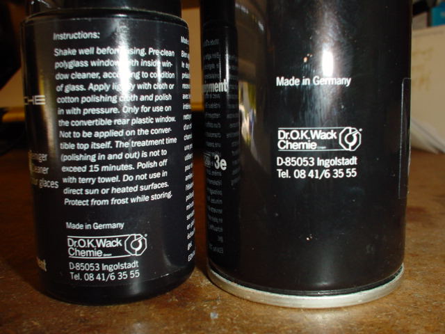

The car care products sold by Porsche are made by Dr.OK.Wack, a German based chemical company.
http://www.wackchem.com/

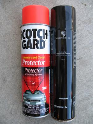

In the olden days people were using 3M Scotchguard as an inexpensive alternative. Someone gave me a can of it but I never used it. In fact, both of my cans are so old they cannot be California VOC compliant. Because of out goofy laws 3M reformulated years ago, and I lost track of why it fell out of favor.

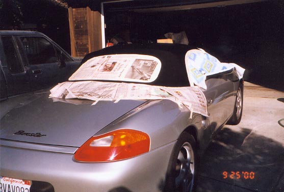

TP, I'm curious what it was about the Porsche protectant you didn't like? I masked off my top and unloaded a full can on the cleaned top. It seems to work pretty well for me.
Also, you mentioned the 3M Scotchguard. I wanted to use that a couple years ago, so I called them to ask but they did not recommend it for convertible tops. Have you found one that is specifically recommended for tops?
