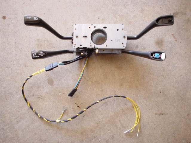

I purchased the 4 stalks control unit and I also purchase a cluster that came with OBC function (when I start my car, the cluster will display outsode temperture and do a serive check on the car.)
Here is my question:
at the bottom of the 4 stalks control unit, there are two connection, one is for curse control and the other is the OBC.
I can't find any connector from my dash board are that connect to the OBC connector from the 4 stalks unit.
Can anyone give me some hint what can I do to make it works
thanks
The car is not prewired for the OBC and that is why you cannot find a connector.
You will need to buy the connector, 5 VW wires, and make a wiring harness. 4 wires go to a connector for the instrument cluster and the 5th wires goes to ground.
thanks
Do anyone know whether I can buy the female conector (showned on the above picuture) to fit in the male connector that came with the stalk unit
  • 1 year later...
I purchased the 4 stalk from Sunset in November and I am just now getting ready to do the hack. All parts were under $200 and the female connector or plug socket was $2.86 PN 999-650-513-40.
