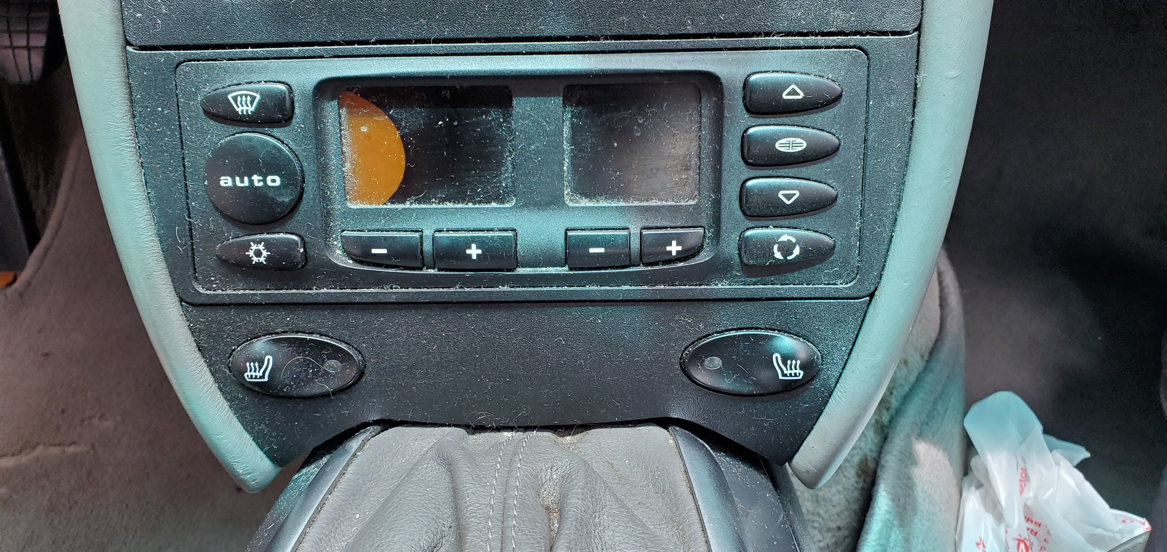

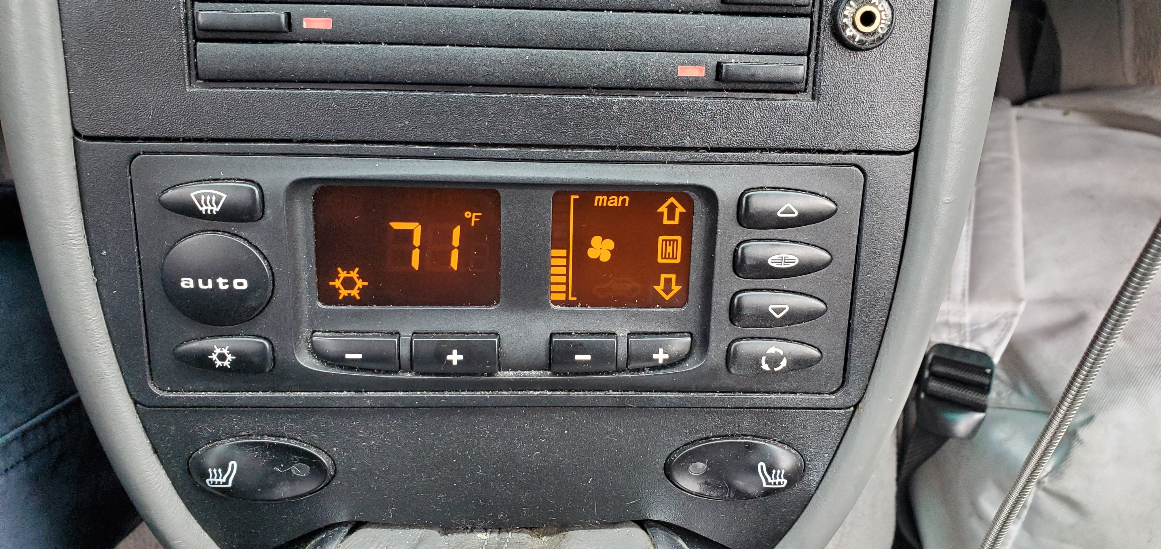

I bought a LCD replacment screen from Vertex auto and installed it myself.using the online instructions and watching a similar video.
It took less than 20 minutes and while the images are a little different now it works better ( when I had directed air-to-air blow down or at passengers I would get small to windshield and it would fog up.   Not anymore. )
I've attached before and after photos
