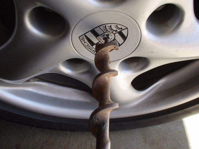

i don't know about that drill bit method! ;)
you can make your own removal tool with a metal coat hanger. cut the coat hanger at one of the corners so that you have a metal 'V'. bend the ends of the V slightly inward towards each other. insert the ends into the two holes in the wheel cap, squeeze, and pull. ta-da!
you could also take the wheel off and pop them off from the inside.
Chris, thanks for your response. The wheel will be off the car so it looks as though this ought to be a very simple task. It was just that I read of someone having difficulty removing the cap, even with the wheel off, that made me think this might not be so straightforward. I've only had the car a few months, it's my first Porsche, and not had any need to remove a wheel until now.
