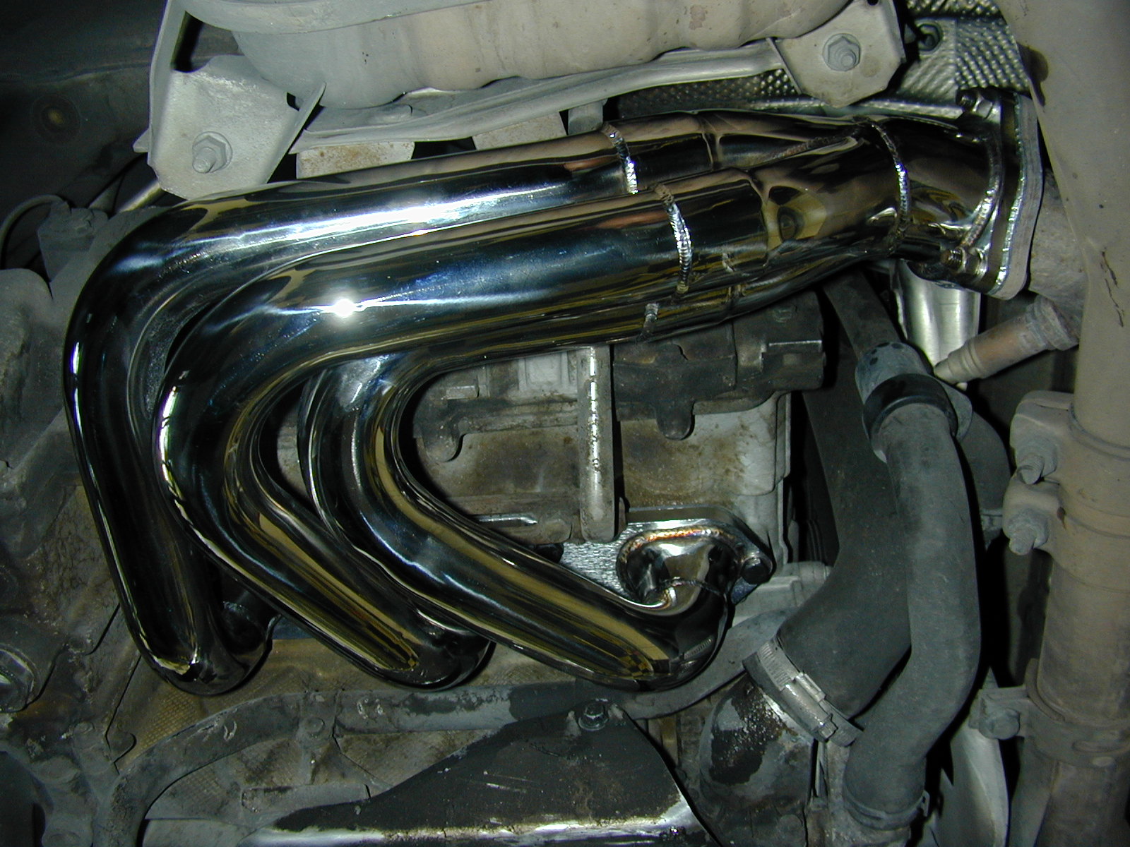

I happen to be in the same PCA club with Marc Reviel who owns http://www.turbowerx.com/ . He tested out a set of his new headers on my 996 and did before and after dyno tests at the wheels (where it counts). I noticed a few benefits and would suggest the upgrade. I had a bit of a power dip in the 5600-6600rpm range and the headers knocked that right out. I felt (seat HP) the improvement and think that if you know your car, you'll be able to tell even subtle differences. In my case I noticed a bit of power along the whole range. I dont work for the company but I am a believer. And at $800, it's far cheaper than other headers. I can say without any doubt this is a worthwhile upgrade.
All that and it's very shiny.

So you don't buy the Butt-O-Meter measure tool? Me neither, but follow the link above the picture, has the dyno test in the website. I did, and it looks like max peak 20 hp gain at some point above 5K rpm. But for the rest of the powerband is closer to 4-5 hp (hard to read graph) increase, sometimes 10. What the dyno test did not cover is if the mufflers or intake where also modified or not, which could make a bigger difference.

Verrrry interesting. This graph shows the huge "power dip" that Idfelix describes. This dip is (maybe intentionally) omitted in any Porsche documentation of the 996 engine. I suspect they oversmoothed the data to eliminate it. More than a dip, the HP actually flattens then climbs again starting at 6000 RPMs. This is something that I can definitely feel in my 02 C4 Cab. Until I saw this graph, I was puzzled by this phenomenon.
If anyone's interested, this dip then recovery is typically caused by either intake tract, exhaust plumbing, or valve timing being mismatched where they are tuned for different peak power RPMs. The result is that the engine has 2 (or 3) different RPMs where it has the most volumetric efficiency (breathing ability). The most famous occurence of this was the old Indy cars (I think) that had different 2 different length velocity stacks. The practise was adopted to reduce the power dip between "happy" RPM ranges. The OEM header on the 996 is like a 3 pronged "F" where 2 of the 3 primary pipes are the same (effective) length but the 3rd is different. If I had to bet, I'd put this as the most suspicious cause of the dip. Installing an equal length header apparently clears it up providing the header is of other geometry that the engine likes.
