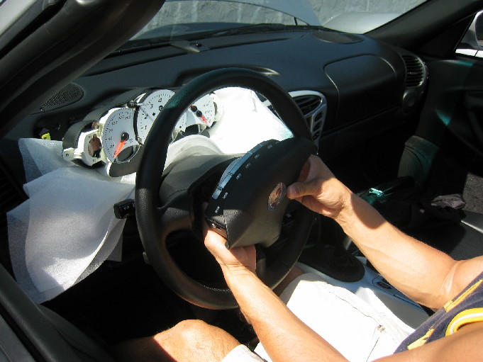

Henry did the exact same thing on his 2000. Perhaps if he has any tricks on the needles and he sees this he will give you a hand.
Henry's pic.
Henry's pic.

You test the needle position before you put the cluster back together. Ignore the air bag out in the picture as Ray also replaced his 4 spoke steering wheel with a 3 spoke at the same time as the face replacement. We needed an air bag hooked up when the ignition was turned on to test the needle position.
