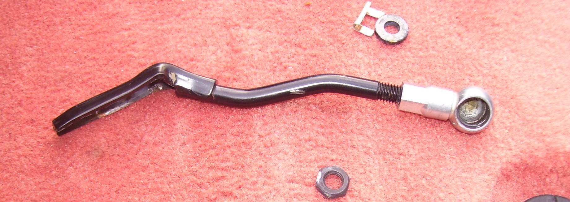

i believe that the ball joint on the V-lever is supposed to have a brass clip (on the rear side of the V-lever) that holds it onto the V-lever. if there is no clip holding it to the V-lever, that might explain why your conv top push rods keep popping off. when they pop off, are they coming off from the V-lever side (ball joint side) or the conv top side (red connector side)?
are you re-using your old and severely bent push rods as pictured above? that could also be the reason. if they are bent like that, you absolutely need new ones.
also, the conv top push-rods are a two-piece rod, held together by a screw in the middle. in your picture you can see that the V-lever side piece is still connected to the V-lever and that piece has a hole in it for a screw to link the two pieces together. do you have the screw(s)?
as far as the position of the ball on the V-lever in relation to the ball on the conv top, you are correct. the conv top push rods 'pull' the top down, and 'push' the top up via rotation by the V-lever. the easiest way to get the correct position is probably to put the top all the way up and latch it, then connect the conv top side of the push rods to the balls on the conv top (from inside the car. it might be a little tight, but you should be able to do it.) alternately, you could do it with the top completely down (from outside the car. you just need to snap that red connector on to the conv top ball.) although i think you will have to remove the large clip-on plastic side pieces that hide the clamshell arms when you are cycling the top. you can put them back on after you've re-attached all the top internals and have made sure the top works correctly. (or you can leave them off - they are purely cosmetic.)

to remove the V-lever, you just need to remove that big bolt right in the middle of the V-lever. i can't remember what size socket to use, but if you have a set just try some until you find one that fits. you said that one of the balls on one of the V-levers doesn't pop out, so look at the back of that ball/V-lever to see how the ball is held on, and then compare that to the one that's popping out. you might need to order a new ball for that V-lever, or a new V-lever if the ball's threads are stripped.
as for the red connector popping off (i understand you have replaced with the metal ones), the only thing i can think of is that because of the bent push-rods, it is somehow working that connector off of the ball when it moves. i would buy new push-rods and try those.
the other possibility is that the metal connector is not 'snapped' on to the ball enough. it is possible that because of the metal construction, there is no 'flex' in the material to allow it to envelope the ball the way the plastic connectors do.
first thing i would do is buy new push-rods. i wouldn't want to take a chance with the old ones. the potential for costly damage is too high.
