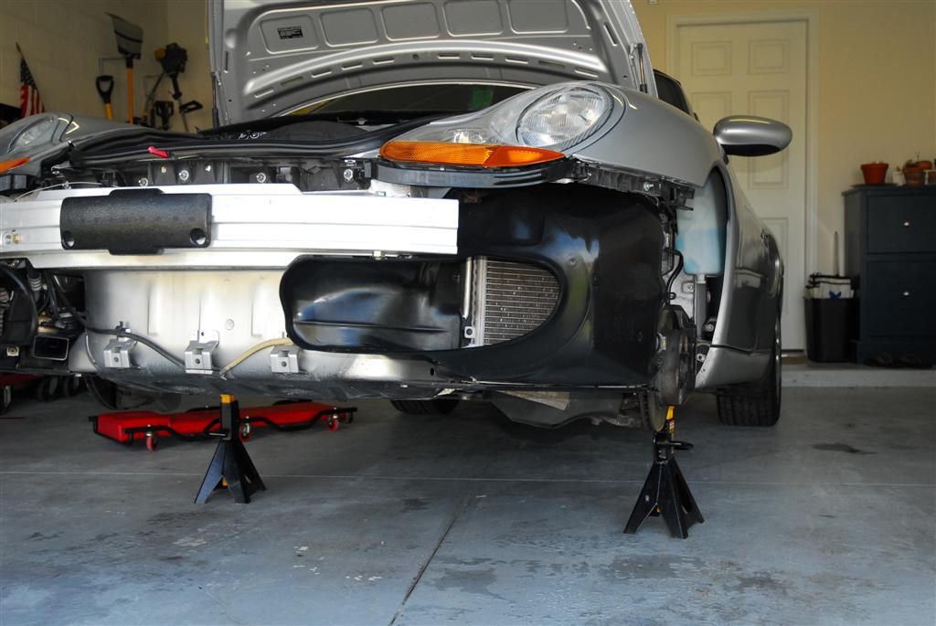

Finally got around to driving to Orlando any buying the rivets for this project.
Spent around 7 hours doing this. A lot of the time was spend cleaning the plastic bits. Alot.

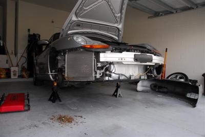

Total to take off the front bumper is about 45min and maybe an hour to put it back on.
I don't know how i picked up a cigarette butt but there it sits.
Anyway so far a success, maybe i am just imagining things but it seems like i am getting
more air through my vents. After 7 hours i must be.

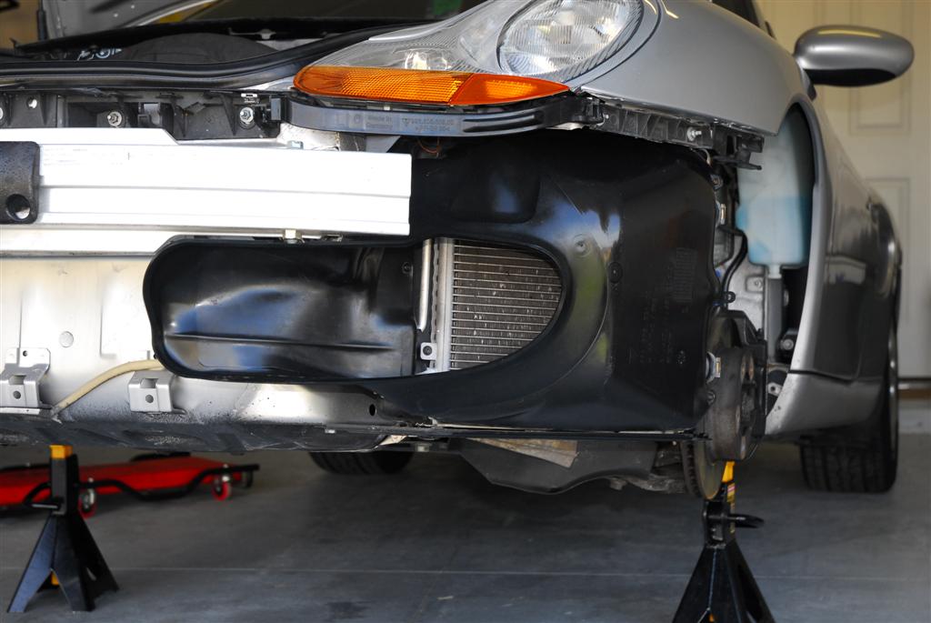

Did you take the two Torx screws out of the AC condensers and clean the radiator behind them?
Yep, slid out fairly easy. Couldn't believe all the crud in there. I wonder how much is still there between the radiator and the fan.
Thought maybe i was going to find our missing cat.

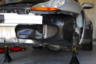

In terms of importance i think this should be a must do project. Some of my concerns before were that i wouldn't be able to get the bumper cover to
sit properly after the reinstall. But Porsche did a great job of making this idiot proof. No matter what it seemed to line up.
The other concern i had was that i would not get the car back togther. But if you can do puzzles aimed at 5-10 year olds, you are set.
The other thing i did but didn't mention is that i used a hose to rinse the radiators. Not a hard spray to hurt the fins, just a gentle flow.
All black bits got the Mothers treatment of "Back to Black". Works great.
