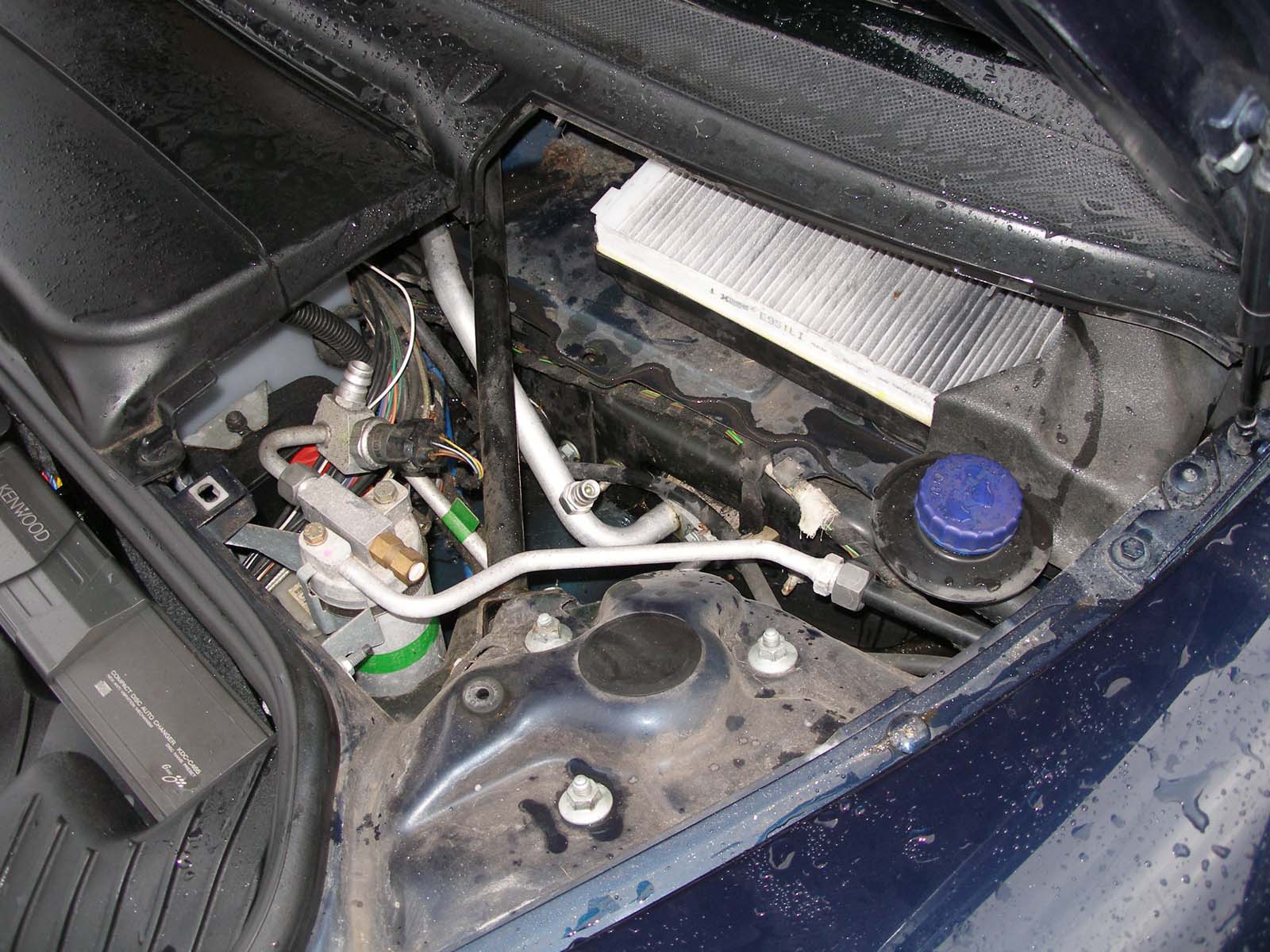

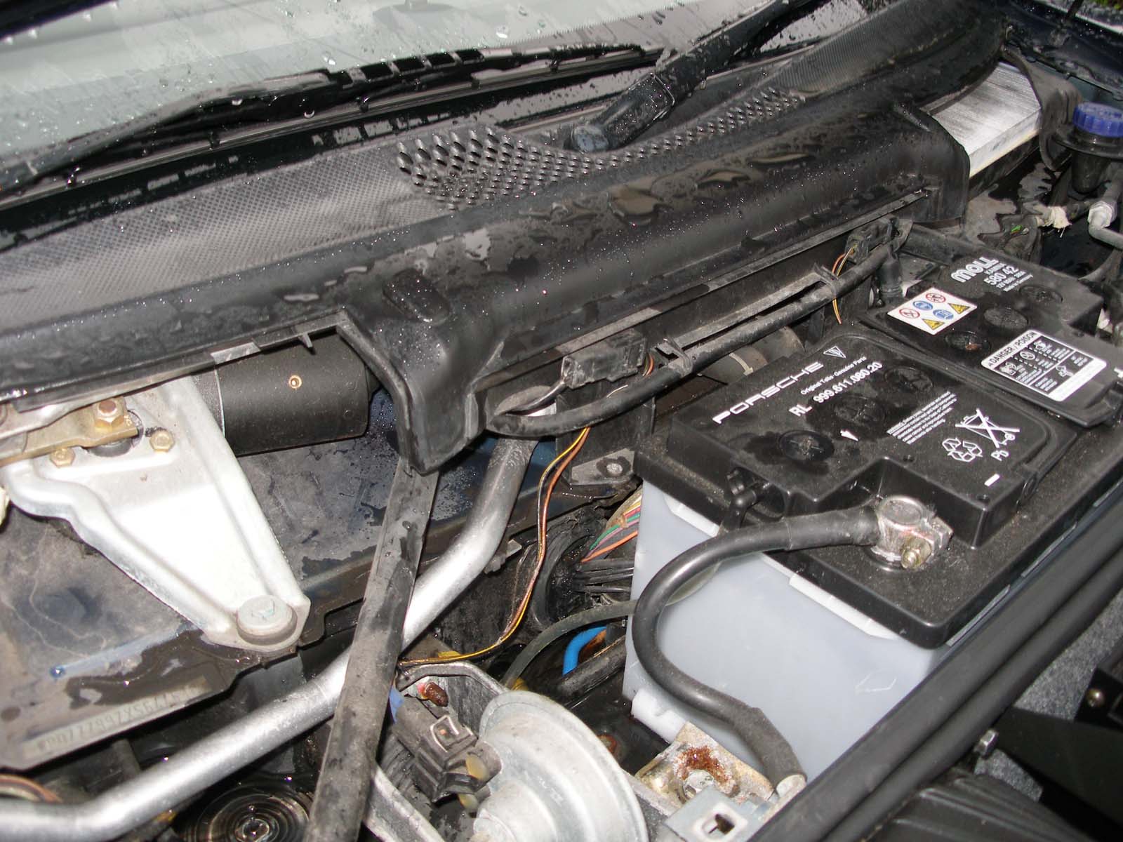

After checking the issue suggested above, I tested with a hose and found a slighlty different case.
It seems the problem is that water comes in through the space around the windscreen wipers spindles then it runs straight down in to the compartment where the battery is. I had a good inch of water in there!
I'm guessing that once it gets to a certain height it flows over in to the boot.

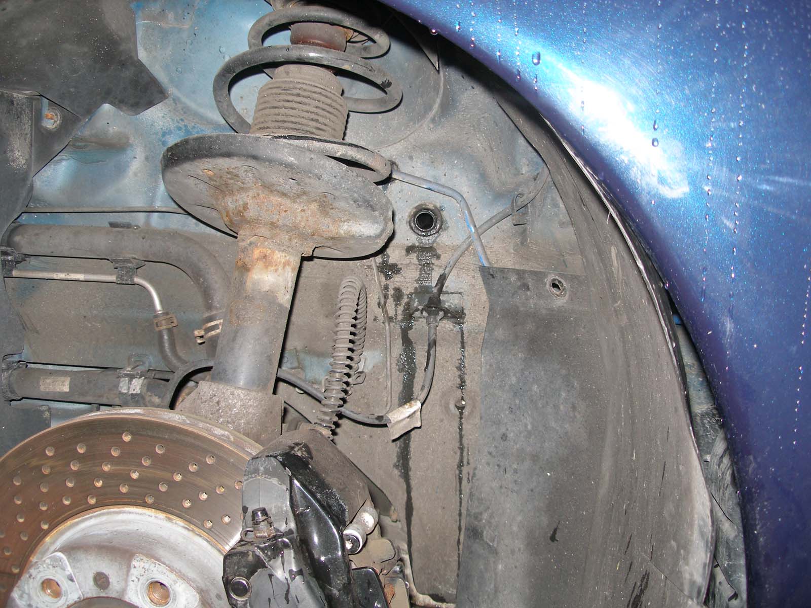

Behind the (UK) passenger side wheel there was a tube.
I pulled this out to inspect it. It was already loose.
No blockage there but it wasn't connected to the rubber hole in the cowel.

After a bit more reading I realise that the 2 rubber parts either side of the battery are in fact the drains! Still not sure what the part in the middle is but that still looks to be under the battery to me.
The problem is that I haven't been able to get to the rubber drains because of the metal pipes in the way. (as shown in the top photo above brake/clutch system pipes?)
So what is the correct procedure to clean these drains out? Can you pull them out with very long nosed pliers and put them back in place after cleaning?
When I tried to poke a thin object in to them one got pushed through and is lost forever! Suggestions weclome!
