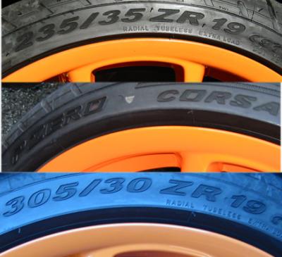

I am most interested in what tyres have been fitted to your car , are they the Pirelli Corsa Race or the Pirelli Corsa System
Also what size are they omn the rear, 305 x 30 x19 or 295 x 30 x 19 ??
Here is a photo of the tire sizes/model. - If this isn't enough, let me know & I'll get a better pic for posting.
...There is a mark which states (in quotes): "(102Y) NO" but nowhere can I find any reference to either "System" or "Race"
I'll look further into the tire warranty materials tonight & let you know if I find anything else.
Thank you so much you have confirmed what I suspected and the Pirelli factory have denied
I will order some straight away, the Michelins are to hard for competition unless conditions are very hot.
The Pirelli's are softer,
The Michelin have a wear rate of 80 the Pirelli have a rate of 60
Pirelli are much better in the wet the Michelin are a terrible wet and coldweather tyre and I would be very very very careful using them !!!!
I have mislead you just discovered these tyrs in the picture are Sysem Tyres , they are a great road tyre with soft compound BUT not good as a track tyre there wear rateing is aroud 120 so are substantaillt harder than the Michelin and Pirelli Corsa race I think thoug for every day use a s a high performance tyre they are great.
