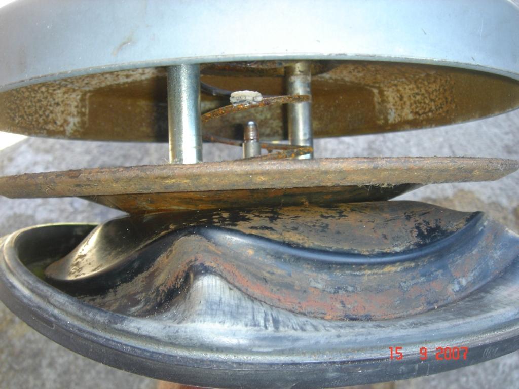

Ok, I finally got around to tackling my Brake Booster problem. I decided to remove the booster to see if there was water in it, and also to see if I could drain it. This was going to be my second time working on the car. (First was the successful replacement of a window regulator). I was advised that the Brake Booster could be removed and re-installed without having to drain brake fluid, or disconnect the Brake Master Cylinder lines.
So here goes, here's my first detailed post.

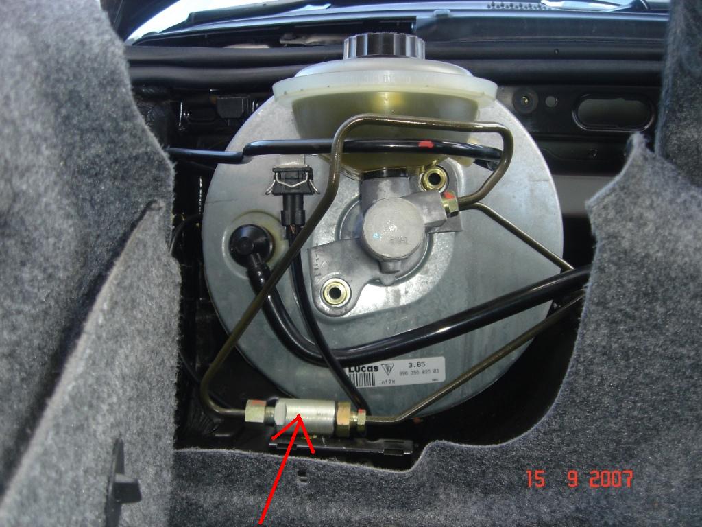

Cleared the front trunk, removed the plastic trim and carpet surrounding the booster.
Remove the two long pan head screws (red arrows).

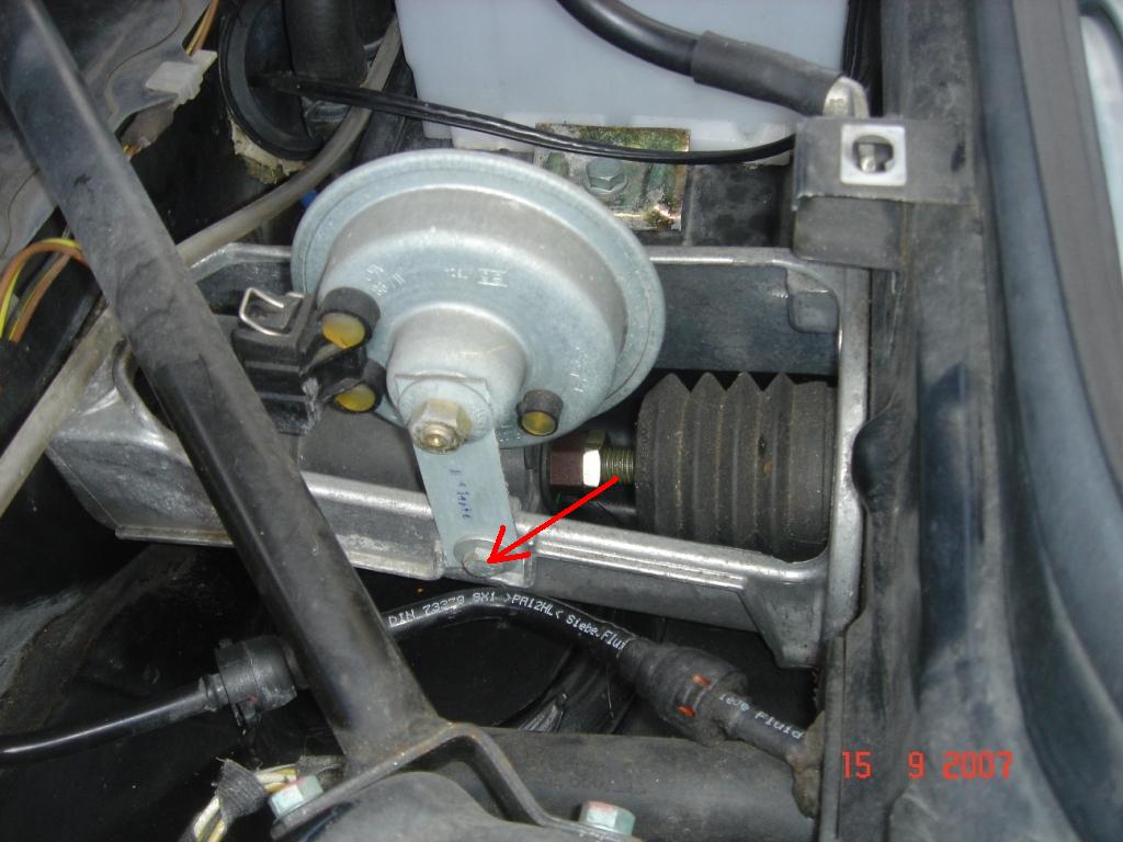

Remove the screw holding the alarm sounder, to gain more access.

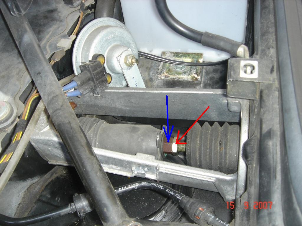

Loosen the lock nut (red arrow) and then loosen the connecting piece (blue arrow). Continue to loosen the connecting piece until they separate.
Whilst loosening this piece, keep an eye on the bracket which holds the brake lines and vacuum line in place. As the booster begins to loosen away from the fire wall, you will need to pull these lines out of the brackets.
Remove the electrical connection (red circle) from the brake fluid container, as this gets in the way later on.
Remove the two hexagon nuts (blue arrows) holding the brake master cylinder to the booster. You may want to temporarily replace the two long pan head screws, to anchor the booster whilst loosening the two hexagon nuts.
Remove the vacuum line connect (green arrow), this just needs a little effort.
Now you can begin to remove the cylinder from the booster, again just a little effort. You will also need to lift the regulator out of its support (red arrow)
The cylinder, whilst still connecting to all of its lines, and the booster can be gently pulled out, and the booster lifted out.

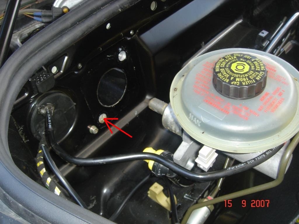

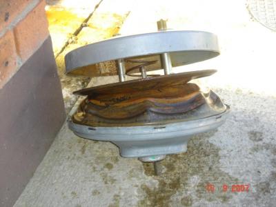

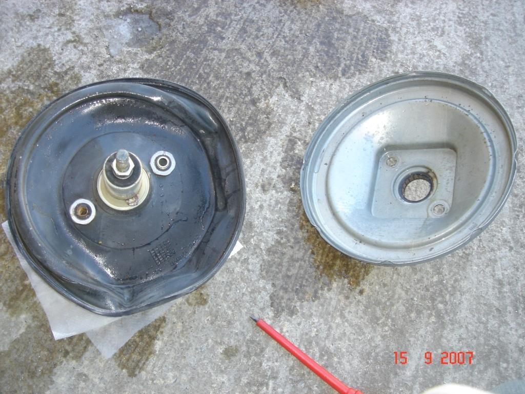

The booster was full of water. I noticed that it is this hole where the water gets into the booster from. The booster seals were leaking under pressure.
It's difficult to drain the water completely from the booster, as there's a diaphram system inside, except through the vacuum connection hole. When I would operate the booster manually, I could see that over time that the seals had worn and were not operating 100%. With all of the visible water, gone, I could still hear water in the opposite side of the booster, so I decided to open the booster. This was done by just prying the clips up, all around the booster. You can see that the booster must have had water in it for quite a long time, as there is alot of rust inside.
I cleaned as much of it as I could, with engine cleaner. I completely dried out the booster, and put it back together again.
Once everything was put back together, I checked the brakes, and it seemed to have helped my problem, but not solve it 100%. I can still drive the car, but I know I will have to buy a new brake booster, but at least I know now, that I can fit it myself. :)

Looking at your pictures and the source of the water that got into the booster I can see why Porsche changed things in September 1999. Very good job of taking it apart and taking pictures.

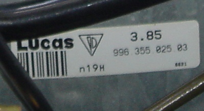

I check the website for a cars part chain that has a shop down the street from where I live. They have a rebuilt booster for $136 USD. It is also used by certain VW and Audi models. Now that I think about it all the boosters I have seen had a Lucas sticker on them. I can see a Lucas sticker on your booster.
Lucas, Prince of Parkness, for electrical parts, and now waterlogged brake boosters....

I will do a write-up with some photos very shortly, but before I do, here is one very quick way to see if there is water in your brake servo:
There are 2 long Screw/Bolt as follows: "Pan Head Screw - M8 x 154 x 80 - 999.073.124.09". These hold the brake servo and master cylinder to the firewall.
Remove the lower of the two, which is to the left, see photo
If this screw has signs of rust along the threads, then the chances of water being in the booster are very high. It is through this hole where the water seeps through. The opposite screw will not have any rust at all, so there is no need to remove that one to check. If there is signs of rust, I would recommend that the screw be replaced but with PTFE Tape (Thread Sealing Tape) along the complete shaft of the screw, and probably go and order a new brake booster, before it gets worse. ;)

Hi CarMan356, great write up and pics which are really helping me out with my sticking brake pedal. 1 question though, "Loosen the lock nut (red arrow) and then loosen the connecting piece (blue arrow). Continue to loosen the connecting piece until they separate." Ive loosened the lock nut but am unsure of the next bit, how does the connecting piece come loose, do i loosen clockwise or anti clockwise?
My thoughts are that the centre thread should stay fixed and the blue arrow bit turns anti clockwise (looking from the windscreen forwards) until it releases but when I do this the thread turns with Blue arrow bit, maybe this is seized on? or am I totally getting this wrong?
Many thanks for a great assist.
