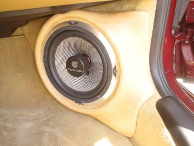

I'm currently going through the process of completely overhauling the stereo in my '00 S which only had the base stereo. Its a big job and a pain in the *** if you don't have a workshop/garage to work in. But basically I've added a Genesis 2 channel amp and a set of Rainbow 3-way speakers. I bought a new set of door cards as I wanted to try to keep everything looking as OEM as possible but here's a list of everything I needed to do:
1. replace dash speakers with tweeter and midrange speaker which involved cutting the original speaker mount to enable the fitment of the larger midrange and tweeter and then epoxy securing them.
2. make a custom baffle to add the woofer and mount to the door
3. sound proof the door i.e. make the door the enclsoure
4. mount the crossovers under the dash
5. mount the amp in the front boot
6. wire everything up - ie getting RCA and remote from the HU to the amp, wiring the amp for power off the battery and the hardest part - getting speaker wire into the doors for the woofers
In retrospect, would I do this again, maybe. Its been a long and hard slog and the improvement is huge but was it worth it, who knows......

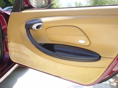

Some of our local guys have this sub. It is made by a local company. An amp is mounted in the front trunk below the latch to drive the sub.
This is Henry's 2000 2.7. As you can see from the second picture he does not have door speakers. He also added a rear speaker kit. I'm not into stereo stuff but it does sound nice.
