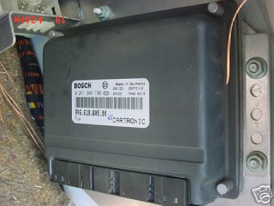

From what you describe it could still be a bad alarm/central locking/immobilizer control unit.
You need to find a shop with a PST2 or PIWIS tester.
The garage is getting an identical car and will swap the ECU and immobiliser to check for faults.
Does anyone know if its possible to fix an ECU if that is the problem?
Only if the DME will allow a re-program - then it is likely still not a long term solution.
The problem is usually not software - but hardware.
In this case I will call a few places and find out if its possible to get a second hand unit of the same kind...2.5 and tip whilst I await the result form the garage.
post-23680-1191643054.jpgI think it's your ECU DME unit.

It seems you are correct. A replacement unit is on its way. I have been told that with a second hand unit the immobiliser and keys have to be changed too.
Cool, glad to hear that. It'd be nice to get her going again but I don't see why they couldn't reprogram your old key.
