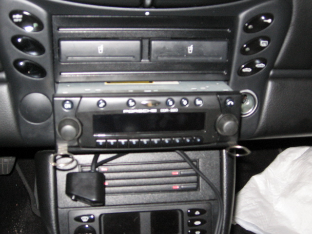

:oops: Hi guys I took my CDR 220 to install the aux cables for the IPOD (I have a 01 Boxster). While the installation worked fine, I can not seem to be able to get the CDR back into the dash. It feels like there is no wire stuck, but it will not go in.

The radio is a tight fit in the slot and you need to wiggle it a bit to get it in at the best of times. Suggest you check the following:
a) that the cables out of the rear of the radios are routed clear of the sides of the radio (ie towards the rear) and not obstructing the insertion of the radio
B) you appear to have your auxilliary cable routed underneath the radio and I think you'll find there's not enough room. Try routing the aux cable out the rear and back through some other part of the dash

First, remove the radio keys and make sure the cables aren't tangled behind it. Also, the cables infront (in your picture) aren't under the radio.
There is a metal bracket/plate that the radio rests on in the center console. If you just push it straight back it will hit this bracket and won't go in. I have done this so much I have pretty good at it. The trick is to push the radio in while pushing down on it, so the back pivots up, hopefully so back will get over the bracket then you can slide it in. You can also remove the AC and the you will have enough room to push the radio over this bracket.

Actually in the picture it looks like the aux cable is routed underneath the radio (sorry), but its actually routed through the back and resting in the space between the dash and the central console...
Rick's comments seem to be right on the money. It looks like some metal bracket or wing is impeding the HU from going in and I am actually trying to place it back by pushing the HU straight.

Thanks guys....It is finally in!!! :cheers:
The frame which hols the HU inside the dash (with the 2 brackets) was slightly bent, hence the HU was getting stuck and bending it even further... I straightened the frame and bingo - the CDR220 slided in (not without some force, but relatively smoothly).
