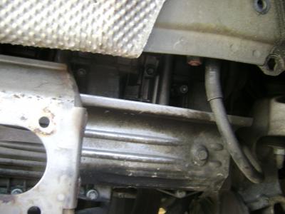

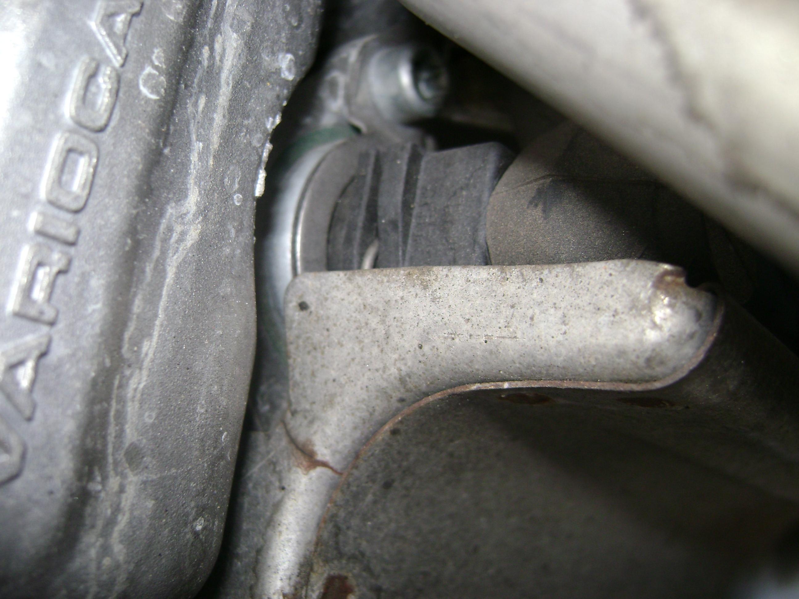

For your convinience, here is the clearance you may get if you decide to remove bumper cover and mufflers. For some (like me with XXL glove hands) it could be easier to get to the bolts on the shield and the plugs. You can see the hex bolts for the coils on the first picture, the second is the harder to reach bolt on the shield (but easy to see here)
