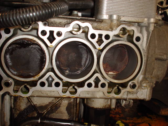

hi, went to put the cylinder head on my boxster today and the very first bolt pulled out of the case( at only 20 foot lbs.) :angry:
has anyone helicoiled the case on this board? is there a special kit for the porsche. I have helicoiled many holes but never a head bolt, especially a 9 inch head bolt. any advice, tips,etc is appreciated.

Bizzare. Long head bolts (or studs) sure, old bugs had heads falling off all the time. Helicoils were on everyone’s service record. Porsche, dunno… but can’t imagine why not. I’d be concerned as to why.

On the air cooled engines they use timeserts, because helicoils can pull out. I have seen engines with the heads off at the dealership, but I never asked if they had one with a pulled out head bolt.

any way timesert is the way to go, you are threading in a steel sleev with new threads for the bolt.
