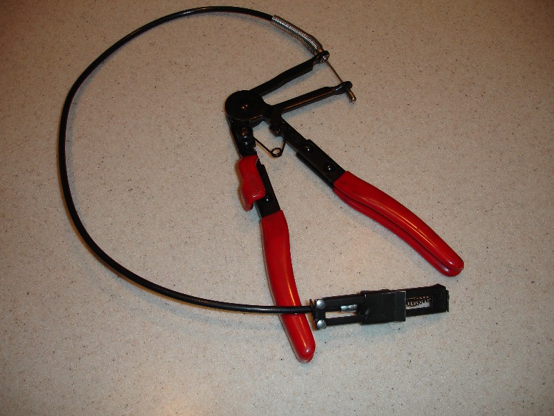

I bought the following "Flexible Ratcheting Hose Clamp Pliers" when I replaced my coolant tank. They were great for the tank replacement. I also used them when I replace the AOS and the oil filler tube. I think it's a great tool to have.
I just about finished AOS R&R with help from Stefan and Bruce. I bought one of these pliers from Sears and they did help. The only issue is that the "head" is too long and was hard to get it into the correct position to squeeze the lower hose clamp on the bellows; that is to have the head parallel to the ground and in the correct location. It is a blind operation so you have to feel your way around. It definitely would have been easier if I had a helper to squeeze and lock the handle while I use both hands to align the "head" of the tool with the hose clamp.

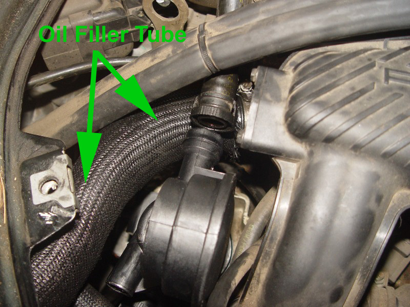

Where is the oil filler tube by the way?
Hung
Hung
It's the tube that connects the oil opening in the trunk to the motor. I replaced it as it was one of the areas leaking oil I was fixing along with the AOS.
