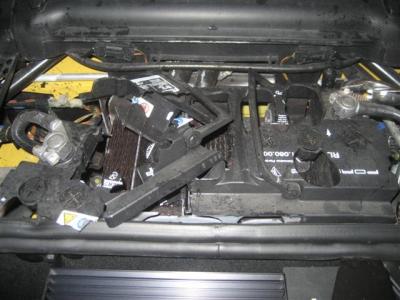

But a 5 year old Moll is living on borrowed time. And sometimes the Moll goes boom....
Mike's guide is excellent. One thing that I would add is that if you're in the store and you see a battery that has the exact right model number but it has an "R" on it, don't get it. "R" means that the battery terminals are reversed. That means the battery cables won't reach the proper sides.
(Note that with the Optima battery, unlike with the other brands, you are supposed to get the "R" model, not the non-"R" model)
