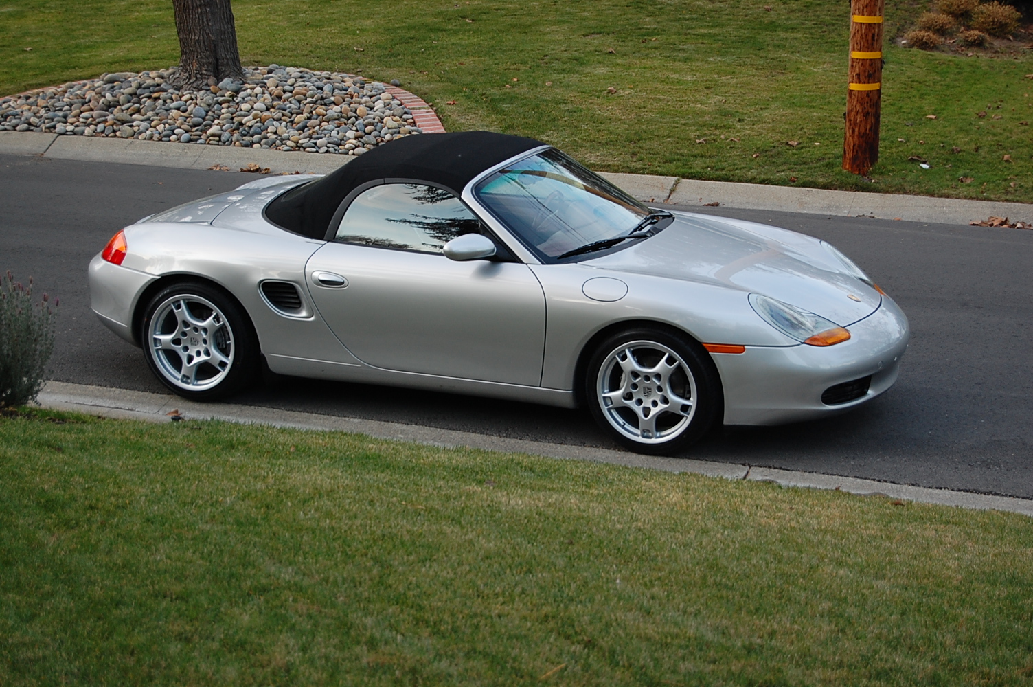

Ijust purchase a set of Porsche wheels 18x8 for the front and 18x10 for the rear to update the look of my 97 Boxster. I am now wondering what size tires I should run, I have been told to run the following sizes:
Front: 225 40 18
Rear: 265 40 18
And was also told by someone the following:
Front: 235 35 18
Rear: 265 30 18
Any experience with this, I just want it to look correct, any advise would be great. The picture enclosed is the look I am going for, and the wheels I have purchased. post-26050-1198519527.jpgThank you

I got the new rims and tires put on today, wow, what a difference!!! It looks awesome, just what I was looking for. I painted the lug bolts semi gloss black, and I plan to put the black plastic caps over them when they arrive. The stock lugs looked really beat up so I had to do something with them. You don't even see them with these wheels.

Another picture
The lug bolts worked great, thanks for getting them to me. I would love to update the lights and get rid of the amber, but that comes with a big pricetag too. I'll probably stick with what I have.
