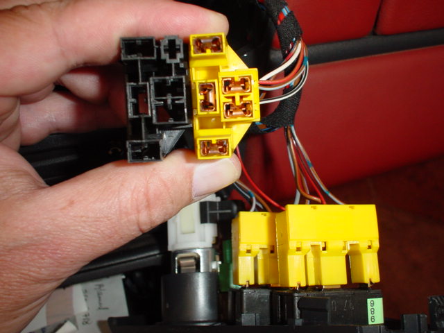

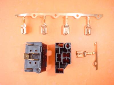

Here is a switch connector. Porsche sells the connectors and pins. I bought the one in the picture as a VW part because it was cheaper. That was a tip I got from Sandy.
Thanks for that tip TP. I want to move the switches because they're not easily accessible. It would be a whole lot better if the switches were located where the cab blanks are in the console between the seats. I imagine it's only a matter of extending the wires and I can't believe routing them will be too difficult a job. I thought it was an obvious refinement and figured somebody on RennTech must have done it at some time.
