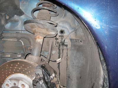

Is it possible to tell what spring and shock are in this photo?
They are no longer on the car. I'd like to know if they look like the original shocks and springs. :renntech:
The car doesn't have M030 on the factory options sticker but it was pretty low already!
Ok, we need the color (or colour in your case) dots on the spring.
Should be two color dots together for spring type and for spring tolerance.
Was hoping that wouldn't be the case. Had the suspension changed over to ROW M030 with H+R springs and the indi binned the old parts so no chance of better phots. It came back at what I think is exactly the same ride height.

Looks like a stock spring. I can see what looks like a yellow dot on the spring.
here is a stock spring and a ROW M030 spring:
Hey thanks Orient Express. That makes total sense (dirty yellow or dirty orange!)
I just don't understand why the car was already so low that after installing ROW M030 there was no noticable effect on height.
I'm was pretty sure the suspension was the original stock set up so around 8 years old. Just began to doubt this when the car came back with M030 with H+R 30mm lowering springs and seems to be the same height.
