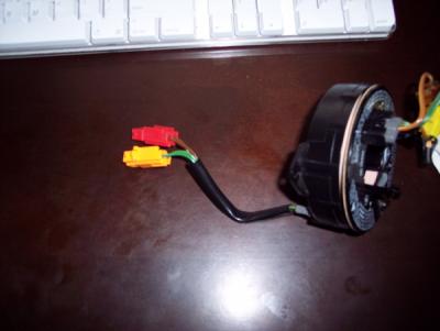

Thanks for the reply, but I need to know how to remove the grey plug as pictured. I have added a zoomed in picture illustrating what needs to be removed. The grey plug that attaches to the plastic ring assembly appears to be latched on or something but I can't figure out how to slide it out.

Figured it out. I decided to go further into the dash and see where this wiring assembly ends. It actually splits into to wiring harnesses just under the dash which you can reach by just removing the top half plastic steering column cover. Here is a picture of what the 2 connectors look like. Thanks Maurice for you reply....just thought I would post back the end result in case anybody else does this in the future.
