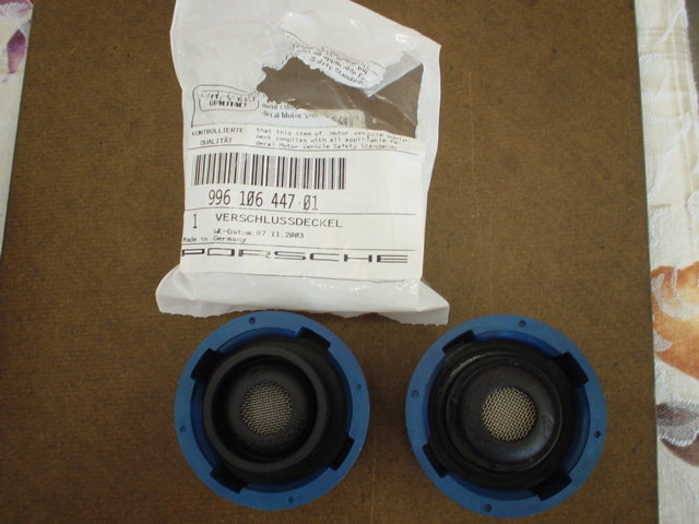

After my first round of refilling the coolant resevoir and replacing the cap with the newer one, I drove about 10 miles and rechecked the coolant resevoir. It appeared to need a little topping up. (Maybe the coolant had not returned to the resevoir or coolant was filled up in the radiator and/or hoses?) I topped it up and drove another 50 miles in mostly 100 degree heat over the course of a day and half. I checked the coolant level after about 35 miles and it was the same as after the top up. I checked it again after the next 15 miles and it's still topped up. The car has been running consistently at about 185 degrees.
I think I got lucky and that the problem was the old cap. I'm going to keep monitoring it and continue to carry a bottle of 50/50 mixed coolant/distilled water around just in case.

Steam is not normal in a fully closed system, I think you'll find the cap is your problem... The overflow in the center of the 'cluster' empties out at the right rear wheel, just as you experienced on the road. As a test, pour a quart or so of water directly into the overflow and watch where it comes out... The fact that your temp returned to nearly normal is not surprising, when my tank failed I could keep it below 200 by going as slow as 20 MPH on flat ground. As for the power washing, I doubt you would have enough direct access to the more vulnerable rubber tubing behind the firewall to do any damage... Hope this helps.
I agree with the other responses. I got lucky with just the cap but it is amazing what a bad cap will cause. Sounds like the bad cap allowed coolant to escape under pressure and drain out. A small thing I found odd about your experience is that you said that your Boxster normally runs 190-200. That seems high to me because mine never goes over about 185 and that's even in my 100-115 summers days.

After reading this thread - I looked under the cover of the 'cluster' and noticed residue. I had the old cap, so I went out and spent $35 on a new cap and a quart of coolant. I cleaned out the old residue and tightened the new cap down leaving the cover off so I could see if the new cap was leaking.

So my leading theory at this point is my new cap is faulty. I'm hoping this is the case because it is the cheapest alternative at this point. As a first attempt, I will go back to the dealer and trade out the cap. After that I will try the pressure test.
Yes, that looks good. Did you say that you already have the newer cap? (The pics show you do.) I guess trying to another one wouldn't hurt. Be careful when putting it on as it is easy to cross-thread them and thus not have a tight seal. (My service advisor warned me of this.) It's easy to do but if you just lightly spin it and let it thread on its own.
