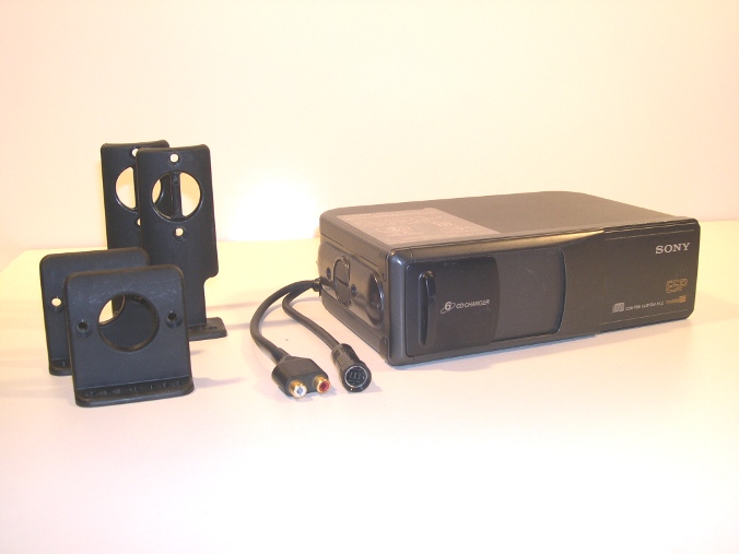

Looking at the connector under the front hood, the changer connection "looks" identical to a Sony one. I am planning to buy a Sony head unit and changer - is the cable identical to Sony's (I presume it is given other info that the Porsche unit is just a Sony with different softwrae)? If so it'll save me having to pull the wire through.
In the meantime, is there any standard Sony CD changer that I can buy that would work with the Porsche head unit?

Well, when I started Boxstering in 1999 about all we had was a CD changer.
The Porsche CDC-3 changer is the same as the Becker 2660 changer. It is a Sony changer with Becker electronics. When I started in 1999 some people were using Sony changers, because it was cheaper than the CDC-3 from Porsche. Once we figured out the Becker unit was not much more than the Sony units, we started to use the Becker 2660, as the Becker cost a fraction of the Porsche unit.
So, the connectors you see look like a Sony for a reason. The changer was made by Sony and branded Porsche or Becker. And that is why when we wanted to buy an extra magazine we bought it as a Sony part, rather than from Porsche or Becker.
You would have to find a Sony unit from around 1996. I think it was CDX-T60 or CDX-T62 and maybe CDX-T65. If I remember correctly there were also 6 or 10 disc units, just like what Becker sold. Porsche only sold the 6 disc unit. With the Sony unit there might also an issue with the GAL feature, or you needed an eprom, or something. I don't remember, as once we started to use the Becker 2660 people were no longer using the Sony. Plus you could not find a new Sony, as Sony changes it's products every few months, and Porsche/Becker every decade.
But then even Becker discontinued the 2660 a few years ago. It was replaced by the Becker 7860, but never sold by Porsche. The 7860 works with the 210 and 220 radio heads, but has a memory issue and is smaller so it is not a direct fit on the factory mounting bracket.

Thanks for the offers and info - since I'm in the UK it's probably not economically viable to import a Porsche changer.
To clarify my choice of Sony. it's to add a DAB interface (just as soon as win one on Ebay....) as I like the digital radio in the UK. Plus when I load CDs they stay into until they've cycled round and then I change them. Yes a harddisk installation would be nice but then I can't have the Sony DAB unit. Can't have everything!

I have a 996 fitted with Cr-22 and CDC3 Becker CD changer (2660). The Cd changer is faulty and I am looking at getting a replacement. I have been offered a Sony CDX T62 and am being told that it is compatible with the Becker head. Can anyone confirm this?

I have a Boxster with the CDR32 head unit. It is already wired up for a (CD) changer. I recently purchased a new Sony CDX-T62 on eBay, but could not persuade the CDR32 to recognise it. I know the CDX-T62 is in working order because a Sony head unit will drive it. I had assumed from the website http://www.986faq.com/4-0/default.asp#M692 that the T62 would work, and I also had the opinion of someone from Sony that it should work. But it definitely doesn't. Car radio dealers I've contacted since (and whom I should have contacted beforehand) told me that the software in the CDR32 will not talk to the CDX-T62, and there is no connecting lead which will solve the problem. Basically, Porsche have just been too clever for some of us...
