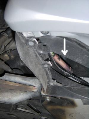

Ultramens - I'm fairly sure you will find it is the resistor that's the problem. It comes with a plug, but the workshop manual says to cut it off, and splice & insulate the wires. Believe me, that is definitely the best way to do it, as you can do the job without removing the front PU.

By front PU, I mean the front bumper. The resistors are clipped to the frame at the bottom of the bumper at each side - if you get underneath they are easy to see - about 5" long and 5/8" diameter, with 3 wires coming from one end.
Switching the resistors will be a challenge. The plugs for them are close to the fans. To get to the plugs you will need to remove the front bumper and several other bits and pieces.
