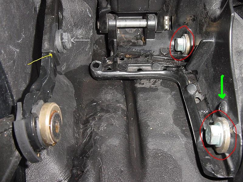

Gus:
It's not difficult to remove and re-install the old top with its mechanism, and there is no comparison between that job and replacing the canvas top. After you have your old top off you can take your old top to an upholsterer to sew in a new vinyl window (should cost between $100 to $200 if you bring them the top and re-install it yourself). That will also give you time to decide whether you later want to "upgrade" to a glass-windowed top, without having to rush into it.
Here is how to proceed:
1. Put the top in the service mode (if you are not sure how to do this, it's in the owner's manual), and make sure the clamshell is at it highest position (45 degree angle, as far back as possible). Unlatch the black/gray vinyl apron from its two plastic retainers on the rear firewall and pop off the two tension cables from their steel balls at the base of the cables. Now, reaching under the B-pillar round black knuckle at its base, pull off the white plastic cups (maybe red plastic if yours have never been replaced) from the steel balls that they are pressed on to. If you have too much trouble popping those off, you can undo the 10mm bolt (with thick washer) from the middle of the connecting arm that leads to the white plastic cups on one end and the front of the V-lever on the rearmost end of it. Before you undo that bolt, mark the point where the two halves of the connect arm are joined so that you don't have to guess at the correct length later. I have attached a photo, where the white arrow shows the 10mm bolt with thick washer. The yellow arrow shows where you should mark the position of the two halves of the connecting arm. The red circles show two of the three large bolts that must be removed (see step #3 below)
2. Now, from the inside of the passenger compartment (behind the outboard side of the driver's seat), remove the semi-circular carpet-covered plastic trim panel from around the base of the roll bar. This trim panel is attached with an 8mm bolt at the top (just loosen it, you don't have to remove it completely) and there is a phillips screw near the bottom that is well hidden in the carpet covering. The screw is about 6 or 8 inches from the floor and just forward of the firewall. Remove the panel. This will remove the defroster hook up, and you will see the B-pillar microswitch, which must be disconnected from its connector near the floor. There is also a zip-tie that will have to be cut, as the zip-tie holds the wire to the roll-bar.
3. Unbolt the 3 large bolts that are visible on the backside of top frame, looking under the rear of the B-Pillar while the top is in the service mode. Some Boxsters have a plastic box covering these three bolts, and this plastic box comes off with removal of two Phillips screws. The large bolts are self-centering, so it will not be difficult to re-install them in the correct position. The top, with the mechanism attached is still very light, but it is a little bulky, so you might want to have someone help you lift it off.
4. You may find a Phillips screw just ahead of the rearmost large bolt (visible in the photo indicated by the green arrow) on each side, and possibly another Phillips screw just aft of the forwardmost lower large bolt . Unscrew those Phillips screws and set them aside for later reassembly. You may also have to gently separate the foam liner from the metal bracket that has been pressed on for many years. Proceed carefully to insure that you do not rip, cut, or tear the foam liner.
5. Once the 3 bolts on each side (left and right) have been removed (and the two Phillips screws, one on each side), just slide the top back about one inch and then lift it straight up.
That's all there is to it.
As far as a reputable shop, there is a shop here on Long Island called Automat (in Hicksville) and they have been doing car interiors and convertible tops for more than 20 years. They advertise regularly in Car & Driver, etc. They do good work, but I don't know what they would charge for sewing in a new vinyl window.
You might do just as well finding a boat upholstery shop depending on how much you want to spend. If you need any other help, drop me a PM and I'll send you my phone number.
Good Luck! If you have any other questions or something above is not clear, let me know and I'll do my best to clear it up.

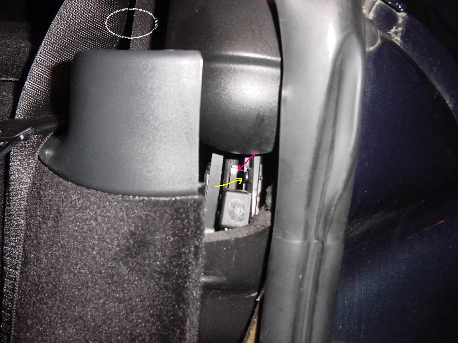

Gustavo:
Here is a photo of that "semi-circular" or semi-tubular carpeted trim piece, showing the B-pillar microswitch (click on the photo to blow it up for a better view):
(Note that for this photo, that carpeted trim piece has already been pulled apart about 3 inches, so as to expose the B-Pillar microswitch).
The red arrow is pointing to the B-pillar microswitch lever arm.
The yellow arrow is pointing to the one screw that you must remove to be able to pull the microswitch off the frame. Aside from that one screw, there is a small plastic nub on the microswitch housing that presses into another hole in the frame.
The white circle shows the general area where the 8mm bolt must be loosened (not removed completely). The seat belts are in the way in this photo, but that bolt is located behind them, just to the driver's side of the carpet pad that covers the engine compartment.
The only other fastener is the phillips screw that is, as I spelled out above, about 6 to 8 inches above the floorpan of the car, just forward of the rear firewall that frames the vertical engine cover.

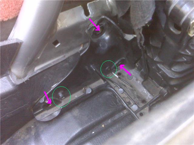

Having just removed the convertible top structure from my 1998 base Boxster, I wanted to share one point that might help someone.
Apparently some 986s have screws in addition to bolts connecting the structural base of the soft top to the car. Maurice's car appears to have one screw on each side.
In my case, there were TWO such screws on each side, and man did I wrestle with it before noticing this. So to save someone else this experience, I attach a photo showing the screws on the passenger side, which appear inside the green circles. The location of the three bolts, which had been removed already, is shown by the pink arrows.
Nurvus:
Thanks for the clarification/correction. I have edited my post above to reflect the more correct information.
