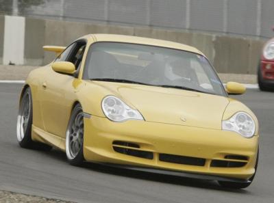

Not exactly what I am saying but along the right lines. I am no expert. It really is a science that I was fortunate enough to witness in a wind tunnel. On a high speed track a wing positioned with additional height at the appropriate angle will provide greater rear traction. As the rear pushes down the front could have the opposite effect creating a stability problem. There is a definite purpose for shims and such but please consider the Cup Lip when you shim the wing. Road courses with occasional high speed straights require greater downforce on the front. A simple change in the lip will make a noticeable difference with turn in requiring less trail braking to keep the front end planted.
The attached photo is top of the corkscrew at Laguna Seca. The car can be at or near 90MPH cresting the hill, breathing the throttle at the crest, then braking, turn in. That little lip you see here on the car made a difference. Look at the grip on the rear tires while the front is ever so nicely pointed. There is a thread here somewhere discussing steering precision. Makes you wonder if it is all about aerodynamics?

Where did you get the Cup front lip? I've had the same concern and haven't rushed to get the shims, since I was concerned about front lift.

Have found some Cup spitters on the internet and can't really tell the difference between those and the stock splitter. Could you clarify the difference?
Hi Gator..... The Cup front air dam for the 996 GT3 is a small amount deeper/wider in the front/center, but is maintains it's width all the way around to it's ends near the front wheel arches. The stock dam/splitter tapers from the front corners to the ends at the wheel arches. The difference may not appear great, but, the aerodynamic difference must be measurable. The Cup dam is cheaper too.
