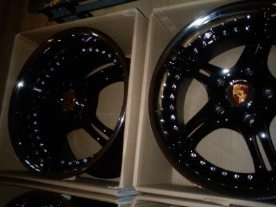

here is a set of 18''''''''''''s I got , I think 18's looks sweet with sport or row suspension :D
